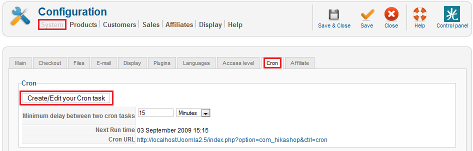

  • Go on your HikaShop configuration page
  • Click on the tab Cron
Create cron
  • On this interface, you can specify the Minimum delay between two cron tasks, which is just for security (so that your website won't be triggered too often) but this parameter has no impact on the real cron frequency (they both should have the same value).
  • Click on the button Create/Edit your Cron task.
  • A popup will open and you will directly see your cron url added (you don't have change it!).

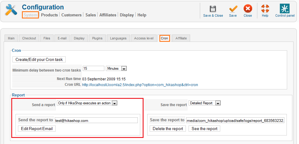

  • Go on your HikaShop configuration page and click on the tab Cron
Test your cron
  • On the Report area, you can see an option to have HikaShop sending you a report each time it is triggered.
    So you can turn ON this option and once your done with your tests, you can then turn it Off.
  • Also, on the Last Cron area, you can see the last time your cron has been triggered, who triggered it and the latest report.
