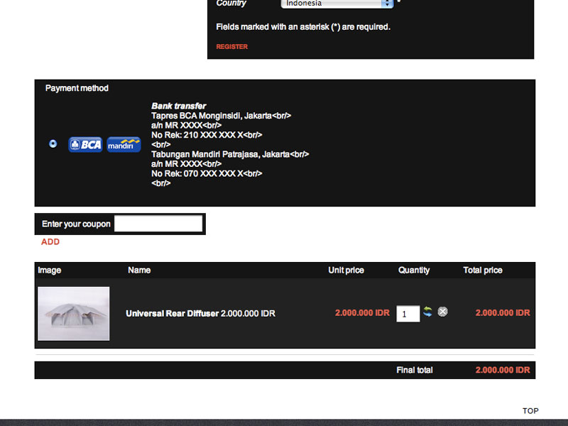

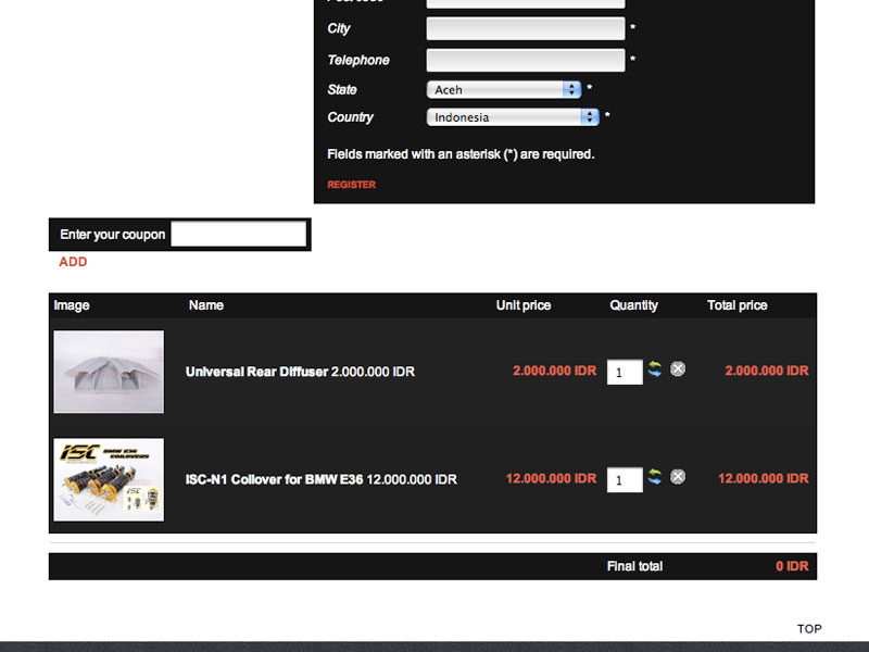

I have problem on the checkout cart final total which the total always show 0.
It's weird that when I run the website on my local server, it's run well, but when I run the website on my host server in the internet the total are not working well and show 0.
It's also weird when i add cart the items with price lower than 10.000.000 IDR, there are no problem at all, but when I add cart the items with price higher than 10.000.000 the total are show 0 again.
Any advice on this?
Any advice on this?
Thanks,
Bobby

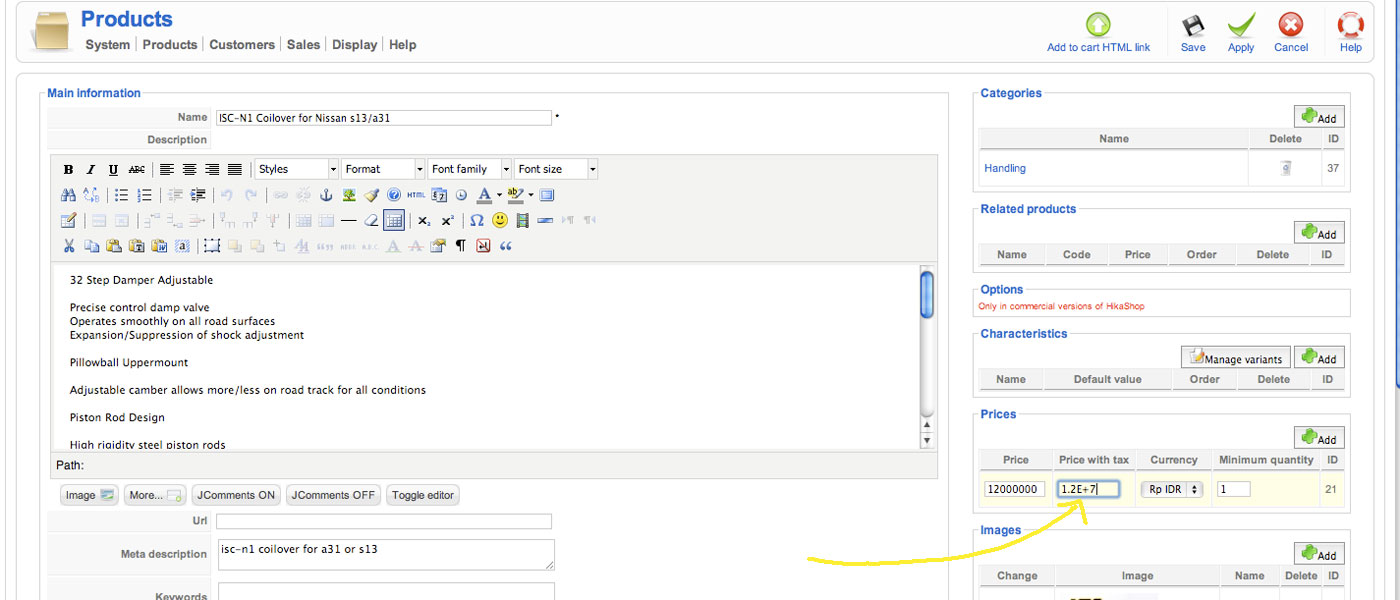

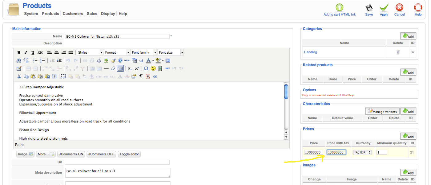

I also found another clue, when I input the price 12000000, the next field "price with tax" become 1.2E+7.
But when I input 13000000, the next field "price with tax" are normally automatic shown 13000000 too.
So what's wrong with number 12000000?

Numbers below are problem when insert into the price items product and also when it calculate total :
12000000 became 1.2E+7
14000000 became 1.4E+7
17000000 became 1.7E+7
19000000 became 1.9E+7
23000000 became 2.3E+7
24000000 became 2.4E+7
28000000 became 2.8E+7
29000000 became 2.9E+7
33000000 became 3.3E+7
34000000 became 3.4E+7
38000000 became 3.8E+7
39000000 became 3.9E+7
those numbers make the total became zero 0
any advice on this?

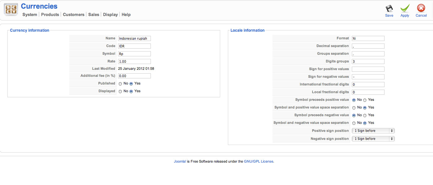

14 years 8 months ago #40238
by nicolas
Replied by nicolas on topic Re: HIKASHOP CHECKOUT CART FINAL TOTAL PROBLEM
I tried on my end but I don't have any problems with these numbers.
Could you do a screenshot of your currency options editions screen so that we can see how you set up your currency. Maybe it comes from one of the settings there...

14 years 8 months ago #40262
by nicolas
Thank you for the information.
