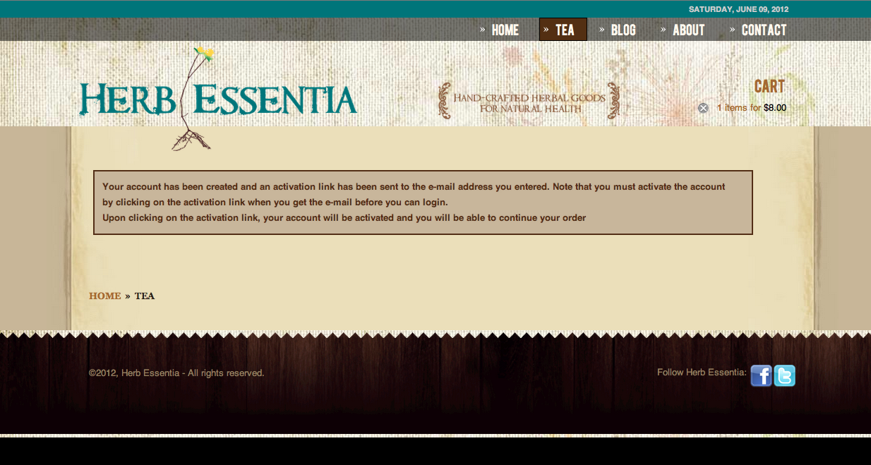

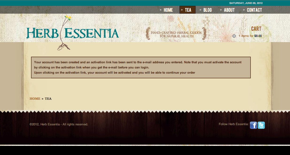

My after_register is blank. I tried adding the <br/> tags anyway, but it doesn't work.
I was trying to follow your directions you posted above, but can't figure out the problem. I am editing the correct template, and not sure where to turn off email confirmation in joomla. I do get the standard "error" message after registering, to go check your email to confirm, it's just that my footer is pulled right up below it.

Here's a screenshot:

  • Posts: 86058
  • Thank you received: 14182
14 years 2 months ago #53362
Yes, the after_regsiter file is empty. And that's normal since you see an empty page.
However, the page on your screenshot is not made with a view. It's not the same page as the page after registration (when activation is deactivated). So you won't be able to change it unless you hack in core files of HikaShop which I don't recommend.
