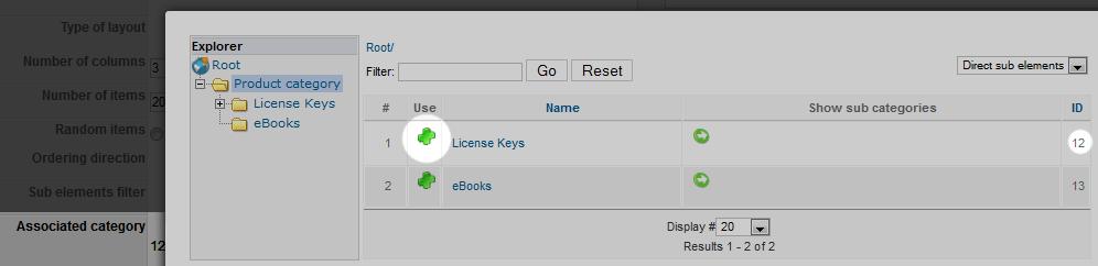

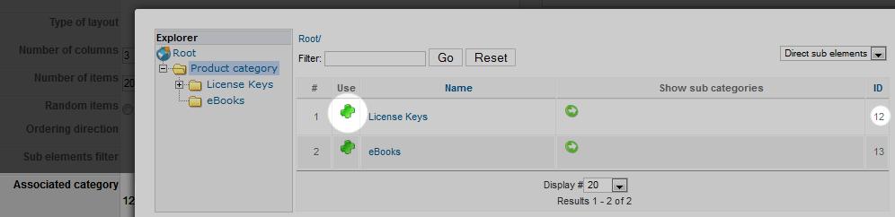

- set the "Associated category" to the category that you want to be displaid
The problem, when i select the associated category, by exemple "vêtements", so i click on "choose" , select "vetements" and when i save the change, it is modified in "2 product category" and never keep my choice.

13 years 11 months ago #76392
by Jerome
Replied by Jerome on topic Problem to display product listing in main menu
13 years 11 months ago - 13 years 11 months ago #76463
by iocom
Replied by iocom on topic Problem to display product listing in main menu
No, i click just next on the name.
On your example, i click on "license keys" ...
And immediately when i apply, the name of my cat is replace by "2 product category" ...
Any idea ? bug ?
Thanks in advance
Any idea ? bug ?
Thanks in advance
Last edit: 13 years 11 months ago by iocom.
13 years 11 months ago #76611
by Eliot
Replied by Eliot on topic Problem to display product listing in main menu
Hi there,
Try to click on the plus, clicking on the name doesn't have the same behavior
