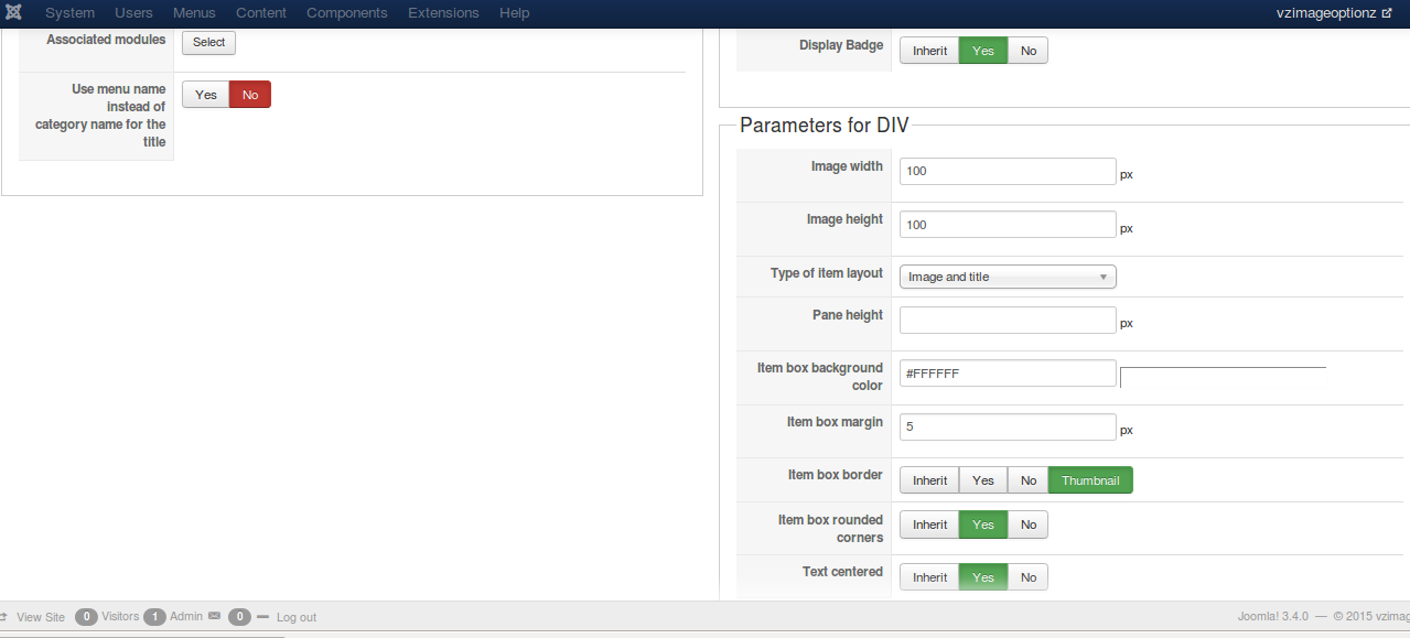

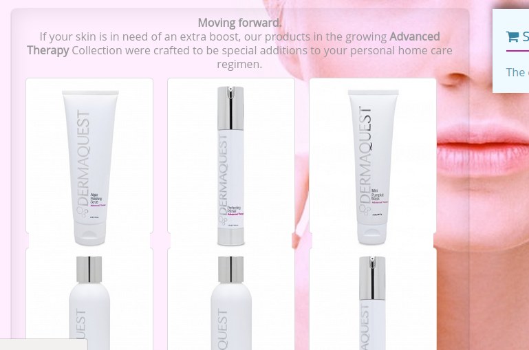

11 years 6 months ago #194692
by vlanciu
Replied by vlanciu on topic Showing image original size on product details
Thank you for your answer, but it doesn't work for product llisting.
- I changed the thumbnail's size in product configuration, to have bigger image in product details page. It works fine
- But for product listing I need smaller images , so I changed images widthheigh in menu product listing configuration, it seemt doesn't change the image size but only div size and the image is shwon bigger that I set please check attached files.
Might be I do something wrong in configuration?

11 years 6 months ago #194725
by lousyfool
Replied by lousyfool on topic Showing image original size on product details
With "original size" you mean "not downsized but the same as uploaded", I assume.
Again, empty the fields for "Product page image width/height" in the system main configuration. That's here: www.hikashop.com/support/support/documen...fig.html#main_images
In the same section, "Thumbnail width/height" is for the (smaller) images in product or category listings. If you want 100x100px as per the configuration in your screenshot, enter these values here. However, you can change these values for an individual listing in its configuration (as shown in your screenshot).
Note that you only enter numbers - not "px". And don't forget to save.

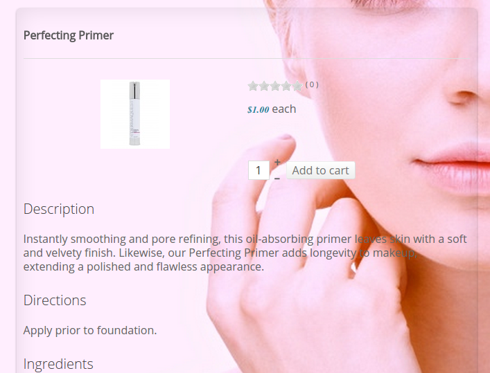

11 years 6 months ago #194731
by vlanciu

11 years 6 months ago #194740
by vlanciu
Yeah , I know that Hikashop regenerate the thumbnails. Let me explain again the problem.
- When I go to product detail page it shows me all images of product
- But these are thumbnails and for view whole image I need to click to thumbnail and popup will show real size image.
- I don't want to have thumbnail on product page but rigth way big image (original size, or bigger size than thumbnail).
* Cause having small image in product page doesn't seam well for me it's not informative.
- The resizing thumbnail image to bigger in hikashop configuration also not solution cause it cause bigger images in product list module.
Think it's should be more clear now.
Thank you
Thank you
