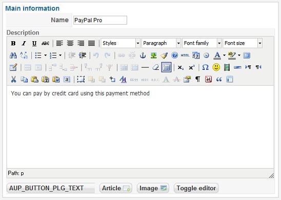

Main Information
If you use one of our commercial versions, you will be able to enter the name and description in different languages. This feature requires to have joomfish installed and can be activated in the configuration page, in the display tab. The languages available will be the ones in joomfish. If you don't enter something for a translation, it will just use the default information in the Main information tab instead. After you click on save or apply an additional publish icon will appear next to the fields where you entered something in the languages tabs so that you can easily enable or disable them. The default publish status can also be changed in the configuration page of HikaShop.

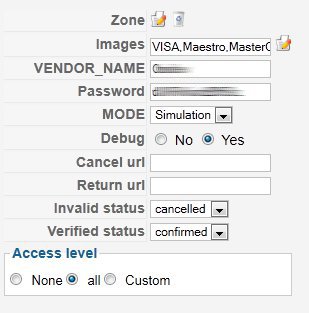

Additional Information
- Vendor name: Your SagePay vendor name.
- Password : The password that was sent to you by SagePay when you registered.
- Mode: You can choose here the the environment to use. Simulation is used for testing the SagePay payment method with a simulator account, so that you can check if your parameters are right and see if data are transmitted. This environment is used during the test phase and transactions will not be credited, once your method is rightly configured, you can switch to the Production/Live mode with your real account and if you have a problem, you can try the Testing/Debug mode. If you want to create a simulator account, you can use the link : https://support.sagepay.com/apply/requestsimaccount.aspx
- Debug : You can activate the debug mode of the SagePay payment plugin. If you do so, informations about each transaction made with SagePay will be logged in the payment log file. You can see and modify the location of this file in the configuration page of HikaShop.
- Cancel url : The url you want your users to be redirected to when they cancel the order from the SagePay interface. By default, they will be redirected to the first step of the checkout process.
- Return url : The url you want your users to be redirected to when they finish their payment on the SagePay interface. By default, they will be redirected to the after_end page of the checkout process which will thank them for their order.
- Invalid status : Here, you can select the status to set to an order if the plugin receives an invalid notification from SagePay for an order.
- Verified status : Here, you can select the status to set to an order if the plugin receives a successful completion notification from SagePay for an order.

Restrictions
- Zone : You can restrict the check payment method to a zone. By clicking on the edit icon, a popup will open enabling you to select a zone. You can also remove this limitation by clicking on the delete icon.
- Shipping method : With this option you can select the shipping method for which this payment method will be available. For example, if you choose UPS, this payment method will only be usable if UPS is selected as shipping method. If an other shipping method is selected, this payment method will not be displayed. Note: if you selected "None" or don't select any shipping method, this payment method will always be available.
- Currency: Choose the currencies allowed by this payment method.
- Minimum price : The payment method can be available for only orders above a minimum price. This price uses the payment method price currency even if the price is 0.
- Maximum price : The payment method can be available for only orders below a maximum price. This price uses the payment method price currency even if the price is 0.
- With tax : Display the payment method only for products with tax.
- Minimum quantity : If the order has a price lower than the price set in this field, so this payment method will not be available.
- Maximum quantity : If the order has a price upper than the price set in this field, so this payment method will not be available.
- Minimum weight : You can set a minimum weight so that orders below it won't be able to be paid with the current payment method. The weight of the order will be calculated based on the weight of each products in it.
- Maximum weight : You can set a maximum weight so that orders over it won't be able to be paid with the current payment method. The weight of the order will be calculated based on the weight of each products in it.
- Minimum volume : You can set a minimum volume so that orders below it won't be able to be paid with the current payment method. The volume of the order will be calculated based on the volume of each products in it. The volume is calculated with the width, height and length of the products.
- Maximum volume : If the order has a volume upper than the price set in this field, so this payment method will not be available.
- Prefix : You can restrict your payment methods to only post codes including such prefix with this option.
- Minimum post code : You can restrict your payment methods to only post codes within a certain range whereby this is the minimum possible value
- Maximum post code : You can restrict your payment methods to only post codes within a certain range whereby this is the maximum possible value
- Suffix : You can restrict your payment methods to only post codes including such suffix with this option.
