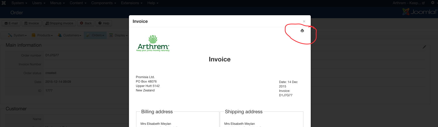

10 years 11 months ago - 10 years 10 months ago #224056
by MSTACE
[SOLVED] Back End Order Print Icon Not Responding was created by MSTACE
Last edit: 10 years 10 months ago by MSTACE.
10 years 11 months ago #224061
by nicolas
Replied by nicolas on topic Back End Order Print Icon Not Responding
We tried on our end but it still works just fine.
If you look at the error console of your browser, to you get any javascript error when doing that ? What is the error message in that case ?

10 years 11 months ago #224184
by MSTACE
Replied by MSTACE on topic Back End Order Print Icon Not Responding
I have turned off all firewall and security software. No change.
Error in console is: "Uncaught ReferenceError: Invalid left-hand side in assignment"

10 years 10 months ago #224443
by Xavier
Replied by Xavier on topic Back End Order Print Icon Not Responding
Problem solved, on the view "order / invoice" backend template the a tag had the onclick javascript event wrote like that: on-click
Instead of: onclick
So that's why it was not calling the event correctly, this has potentially be edited by you when editing that view as we don't have code like that by default
Instead of: onclick
10 years 10 months ago #224523
by MSTACE
It was driving me crazy trying to find out why that wasn't working, but as soon as you said that the javascript was written incorrectly I knew where that was coming from: RS Firewall
When the backend scanning and javascript scanning is turned on, it will re-write potentially harmful javascript when there is a document save. I will have to remember to totally turn that off before editing any scripts.
THANK YOU for finding it!
