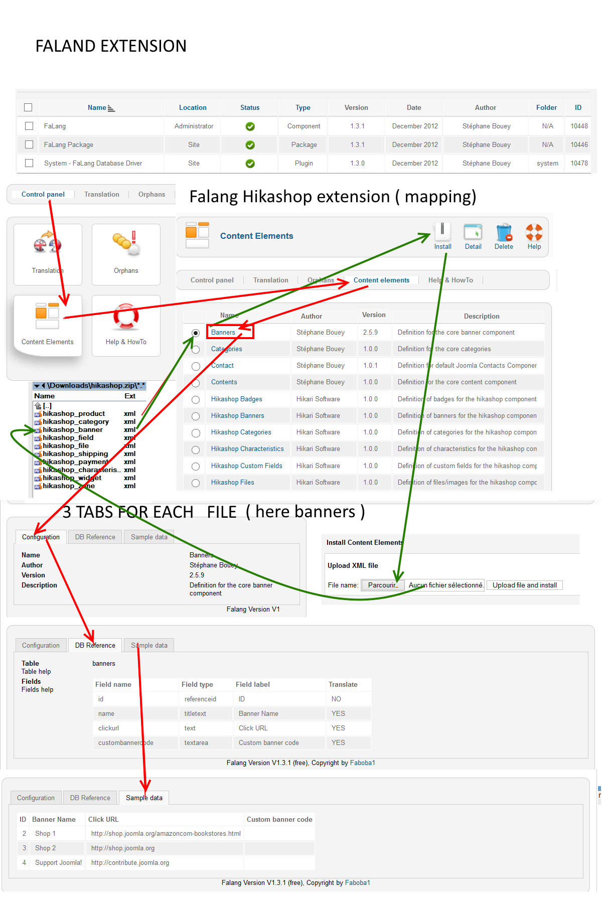

a---and a capture screen to understand better what mean import xml from falang hikashop extension
hikashop_banner.xml

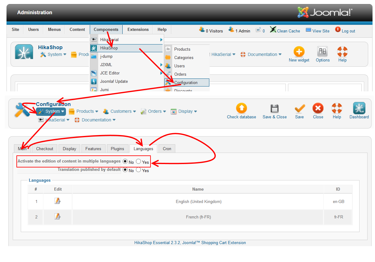

b----capture screen for translate category name here the the step to activate enable the setting
Components -> hikashop -> configuration -> system -> languages -> "actiavte the edition of content in multiple languages " = No/Yes

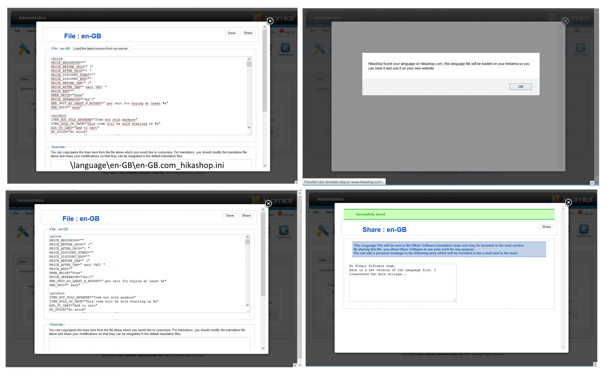

c---capture screen translation file to update share with hikashop team
best documentation about language in hikashop
