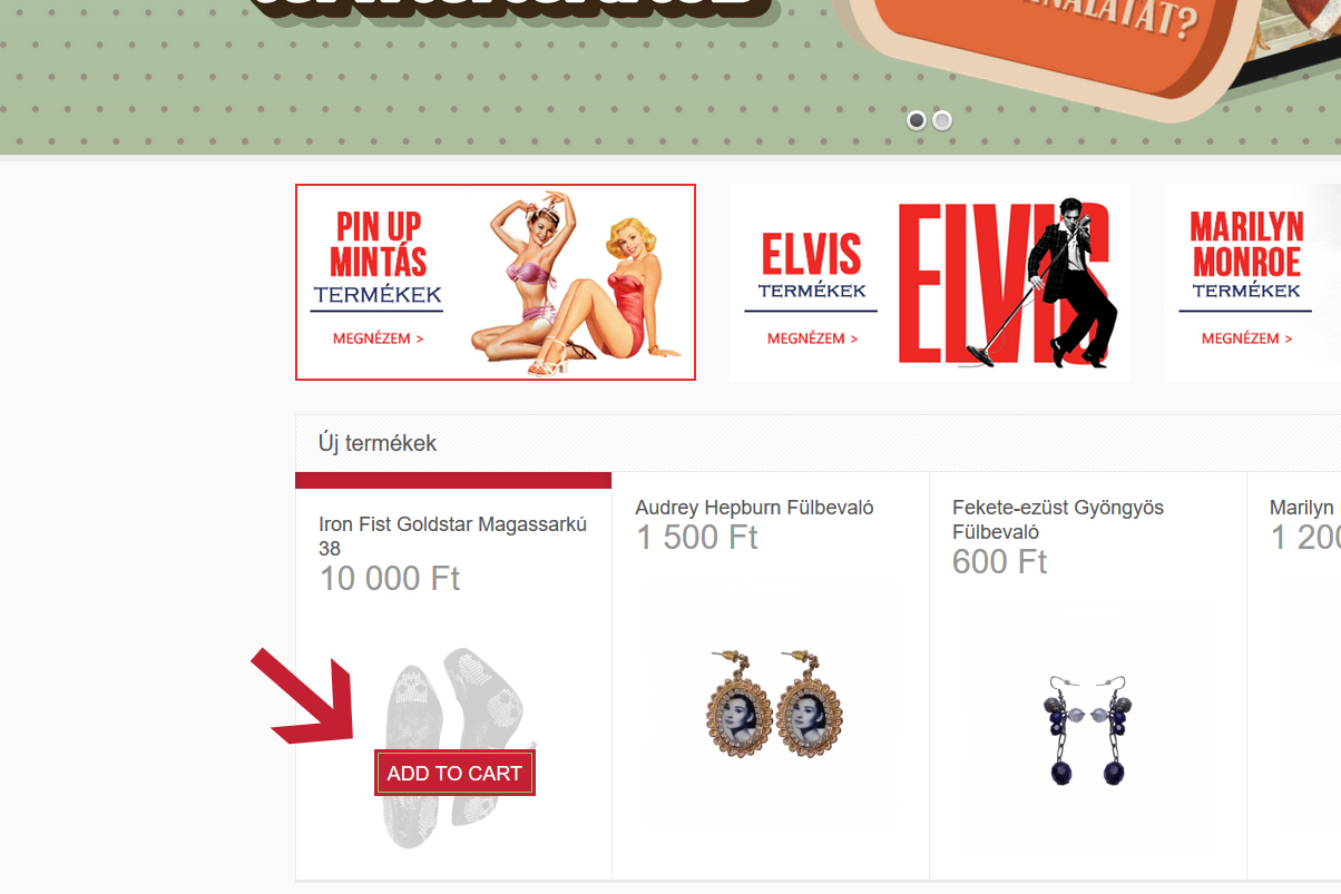

Hi!
I transleted to hungarian all the things successfully on my webpage, except this "Add to cart" button.
I searched everywhere, where can I modify this, but didn't find it.
Can you help me?
Bests,
