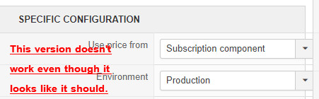

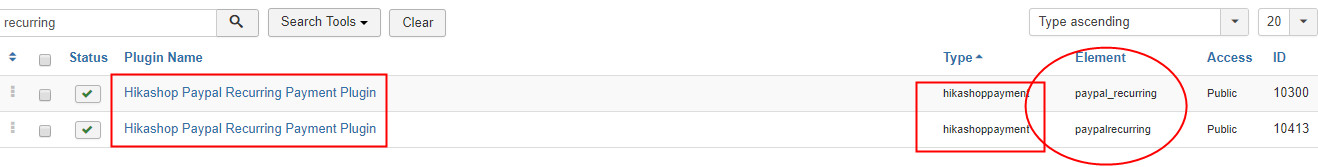

OK, I've found the problem. Or, at least I've identified the issues.
Firstly, you have two plugin's that appear to be the same and Joomla installs both alongside each other. They are identical except for a tiny difference. (Hard to spot so I've highlighted it).
Surprisingly, the interiors of the files are almost identical and perversely the one that offers the subscription option is the one that doesn't work.
So, I have this while I correctly identify and uninstall the offending plugin in Joomla..
Do you think it's a possibility that Hika eCommerce could do something [like give them different names] to help users identify the correct plugin?

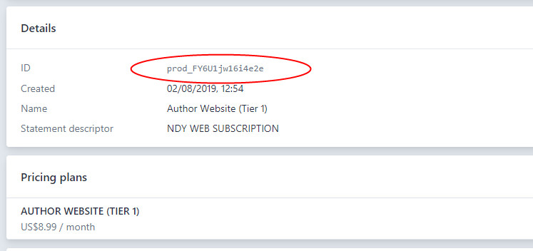

Actually, the plan is a single plan with a singular reference to identify it in Stripe. All that is needed is an identifier in Hika Subscription to tell Stripe to hook that specific subscription template and it will work.
I know you are in the process of updating the Stripe plugin to handle 3D Secure payments. maybe you can include this as another option. Not everyone likes PayPal. A good alternative would be useful.
