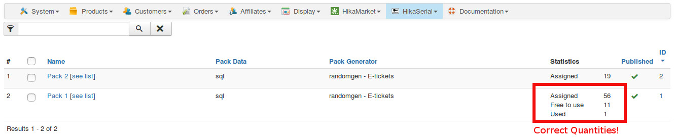

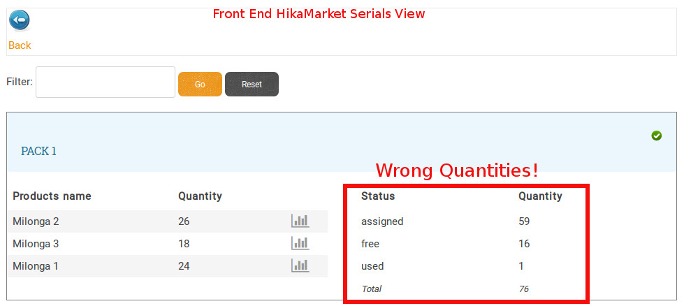

Hi there,
There seems to be a problem with the counter on the serialsmarket Packs.php view. The number of serials that appear in this counters gets out of sync with the database.
Please see the wrong counters in the attached image
The right serial numbers can be seen in the back-end, please see the attached image
The backend numbers match the database numbers, pleasd attached table
I have noticed the following, the numbers in the front end are initially correct, however when I move an order in the backend into CANCELED or REFUNDED status, then the numbers in the front end start going wrong since they keep incrementing the number of serials when readjusting the status of the serials.
This ONLY happens when the order that I move in the backend into CANCELLED or REFUNDED was paid via MangoPay payment method. If the order had been paid with Bank Transfer or Stripe the the counters in the front end seem to readjust correctly
Thank you!

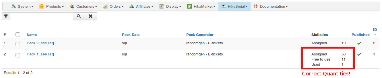

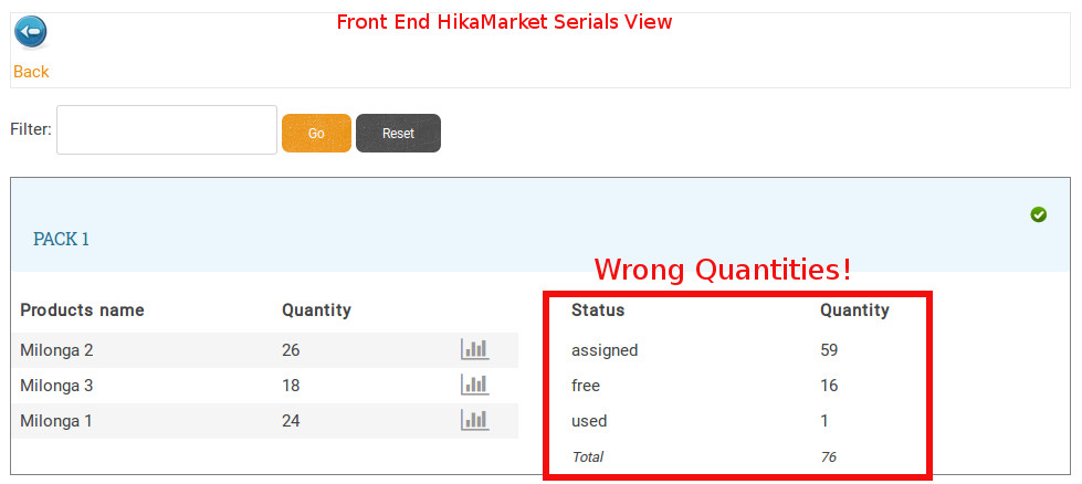

-- HikaSerial version -- : 1.10.4
-- Joomla version -- : 3.6.2
-- PHP version -- : 5.6
Hi there,
Thank you!
9 years 11 months ago #253392
by Jerome
Replied by Jerome on topic Problem with Serials Counter on Front End Vendor view
Can you please indicate the context ?
Are you using the main vendor or a vendor ?
9 years 11 months ago - 9 years 11 months ago #253413
by sabroso
Replied by sabroso on topic Problem with Serials Counter on Front End Vendor view
A vendor in the front end. Then i edit the status of the main order in the backend. Only products from one vendor in the order.
What else do you need to know?

9 years 11 months ago #253474
by Jerome
Okay so your configuration is: a vendor who display statistics for a pack he is managing.
In the "serialmarket/view.html.php" file in HikaSerial you have to replace
By
And then
By
So it will unsure that the link made with the orders are made with "user orders" when the pack is managed and with only "vendor orders" when the pack is not managed.
Because the link was only with the vendor orders ; by having several "vendor refund" in the database, it was affecting the count of the serials.

9 years 11 months ago #253513
by sabroso
Thank you, this is working now OK
