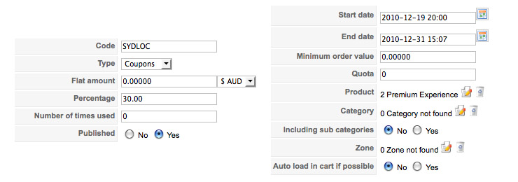

The following images is how I set it initially. So I think I am gathering you can only have one coupon code no matter what. Making two with the same name, but different product or different categories with different percentages off won't work?

It won't indeed. The only solution would be to have a different code.
