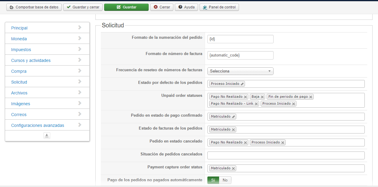

10 years 1 month ago #247827 by dvddvd
Hello!
I have configured various types of state.
Try status "Proceso Iniciado" does not detract from stock .
And the state " Matriculado " reste of stock .
But it does not work!.
The status "Proceso Iniciado" always reste of stock.
I'm doing something wrong !
Thanks!!
More
10 years 1 month ago #247844 by Jerome
Update the product stock on confirmed status: The product stock will be decremented only when the order status changes from created to one of the statuses selected in the "invoice order statuses" option, and not when the order is created.
I can see that you setting "invoice order statuses" is not fully configured.
In your screenshot it is named "Estado de facturas de los pedidos" and just contain the value "Matriculado".

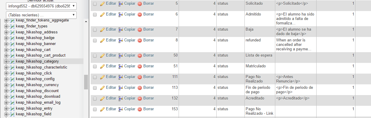

7 years 10 months ago #300708 by dvddvd
Hello Jerome,
I have two states, one of them is "registered" that decreases the stock, since it is confirmed.
And another that is admitted, that is not created or confirmed, and would like this state to also subtract the stock, how can I configure it to achieve it? Thank you
More
7 years 10 months ago #300709 by Jerome
The setting propose only two alternatives :
- When the order is created.
- When the order receive a confirmed status.
If you want something which is not "created" and not a "confirmed status", it would require some custom development.
