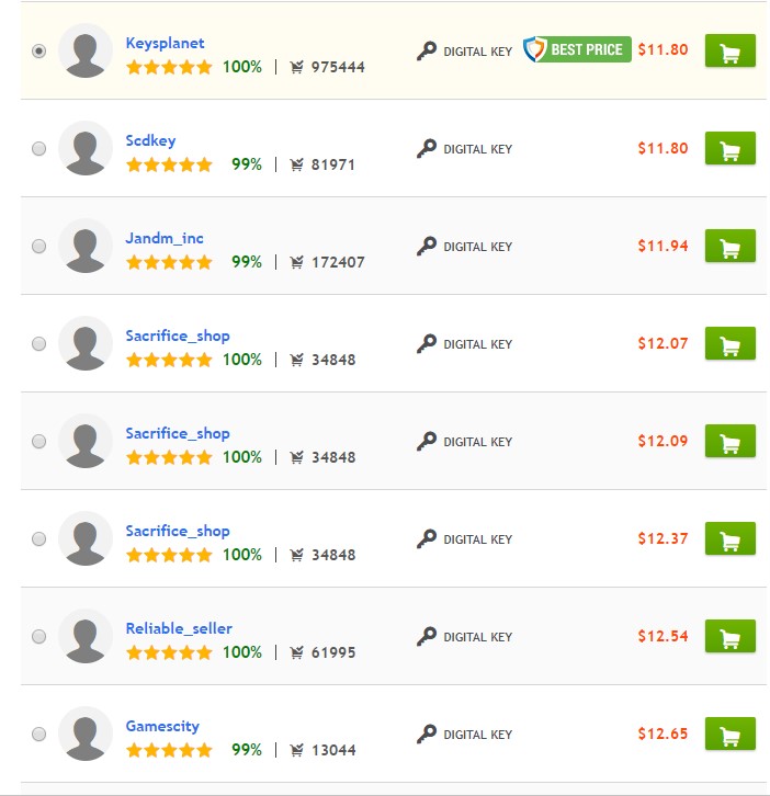

Hi, everything is working properly, but I have a big problem with the method of displaying variants created by other vendors. I want to ask you to make a similar view which will be much better for customers. I really need such a view.

In HikaShop you can use a "table" display for the selection of the variants.
That view can be customized if you want to add columns or change how it is displayed (like organize the variants by price for example).
Unfortunately, HikaShop do not have any useful trigger to change the view that much ; it can interact with a lot of things but regarding your screenshot, I'm afraid that it would require a customization and it cannot be done using a plugin.
I'll discuss with the HikaShop team in order to know if there could have modifications in HikaShop to allow more flexibility for the add-ons but it would need some time for sure.

Hi, I'm trying to create a custom code to insert in show_tabular.php. My purpose is to retrieve only the information that is in the picture:
Is it possible to retrieve information such as a photo and a vendor rating. If it is impossible, can you tell me how to retrieve the information from the picture. Thanks in advance.

Every product (and variant) have a "product_vendor_id".
By loading the vendors, you'll get all the elements you need.

Hi, I want to ask you to add to the variants created by other vendors at least link (clicking on the name redirect them) to the vendor page and show their assessment, to make it easier to track what their rating. I've looked at many sites and have these options. I think this should be by default.

Hi, is it possible in the table is the name of the vendor for example is the name of my company by clicking on the name to redirect you to my vendor page so be for each vendor in the table and next to the name to be the rating of that vendor.
In summary: I think it makes sense in need with a single click to see the page of a vendor or to see his rating in the table without having to visit his page.

Since you have the product_vendor_id ; you can load the vendor.
In the vendor object, you will find the value for the vote.
Afterwards, if you want to generate a link to the vendor page, you can find some sample code here :
www.hikashop.com/forum/23-market-how-to/...dor-page.html#156511
( just replace "$this->row->vendor" by the variable for the vendor object )

Hi, I already understand that the Vendor ID is taken through this code
Code:
$variant->product_vendor_id
This code is already working
Code:
<?php $voteParams = new HikaParameter(); $voteParams->set('vote_type', 'vendor'); $voteParams->set('vote_ref_id', $variant->product_vendor_id); $js = ''; echo hikashop_getLayout('vote', 'mini', $voteParams, $js); ?>
Now remained only do so to load this Vendor by this ID. How can I do that?
More
8 years 7 months ago #287625 by neo191987
Replied by neo191987 on topic Detailed view of variants
Excellent through this code I can do everything. The topic is closed.
Code:
<?php $vendorClass = hikamarket::get('class.vendor'); $vendor = $vendorClass->get($variant->product_vendor_id,'vendor'); ?>
