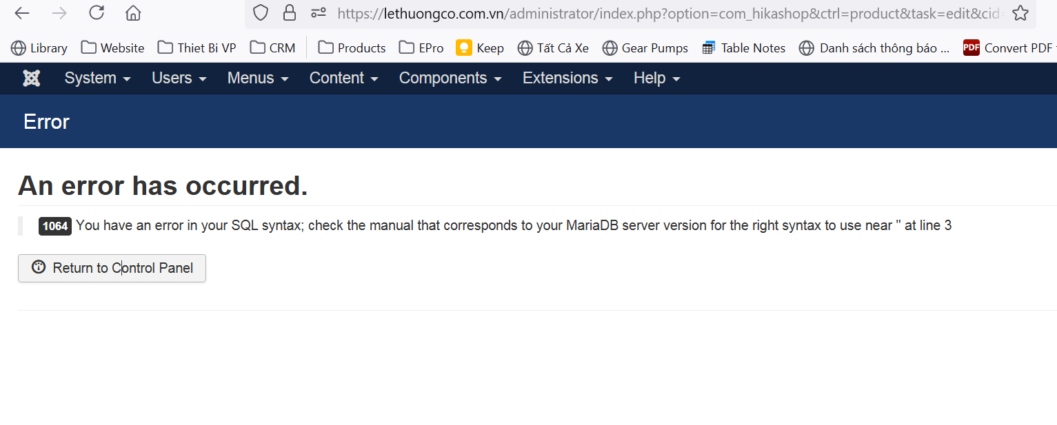

-- Error-message(debug-mod must be tuned on) -- : Product Template
Pls help to check, i can not to create prodcut template

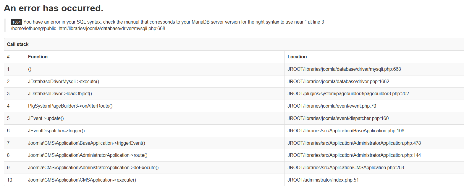

5 years 3 months ago #333792
by tuanan@lethuongco.com.vn
Replied by tuanan@lethuongco.com.vn on topic product template get error
Pls see attached for your more info
5 years 3 months ago #333794
by nicolas
Replied by nicolas on topic product template get error
The error is in the pagebuilder3 system plugin from your template.
You should report the issue to your template provider. The plugin should not have to do anything in the backend area of HikaShop so I guess the plugin needs an extra check in its code.
In the mean time, you can temporarily disable that plugin in the Joomla plugins manager while you create the product template.
