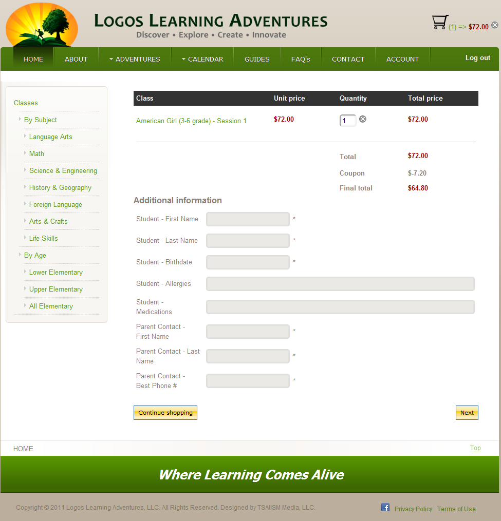

15 years 2 months ago #21381 by tsaiism
During the checkout process, it's showing error message (enclosed) when I have a coupon code. When I unpublish or delete the coupon code (10%), the error message went away.

15 years 2 months ago #21440 by tsaiism
Thanks. The error message went away but the coupon I set up is applying the coupon "automatically" when I added a coupon code. The coupon code was set to not "auto apply." Please advise since it looks like it's doing what a discount type is doing.

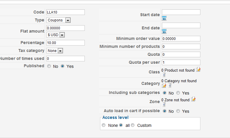

15 years 2 months ago #21446 by nicolas
Please post a screenshot of the configuration of the coupon ?
If the coupon is applied automatically, it must be that the configuration of the coupon has that auto load option on.
Otherwise, everyone else would have that issue when creating a coupon.

15 years 2 months ago #21457 by tsaiism
Enclosed is the coupon configuration:
I tried adding another coupon code and it's still picking up the 10% automatically, but when I deleted the 10% one, the other coupon code seems to work now (w/o automatic apply). I guess the first coupon (shown) is a bad record or something. For now, there is no issue.
