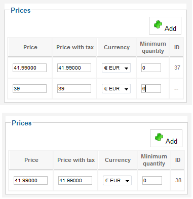

Hello, Im having issues adding prices to my products.
I can add a single product price "Qty=0"
When I try to add an additional price "Qty=6" it won't save.
Rgds
DM
Joomla 1.6

No error recorded!
Works on the demo version, note demo is J1.5 (IE)
Works on Firefox
Does not work on IE
Note the ID of the original price jumps to next available ID after the save button is hit.
Is this the JDebug error you are looking for?
**Parsing errors in language files**
/webspace/httpdocs/language/en-GB/en-GB.com_hikashop.ini : error(s) in line(s) 1, 626, 628, 661, 663
Works on Firefox
Does not work on IE
