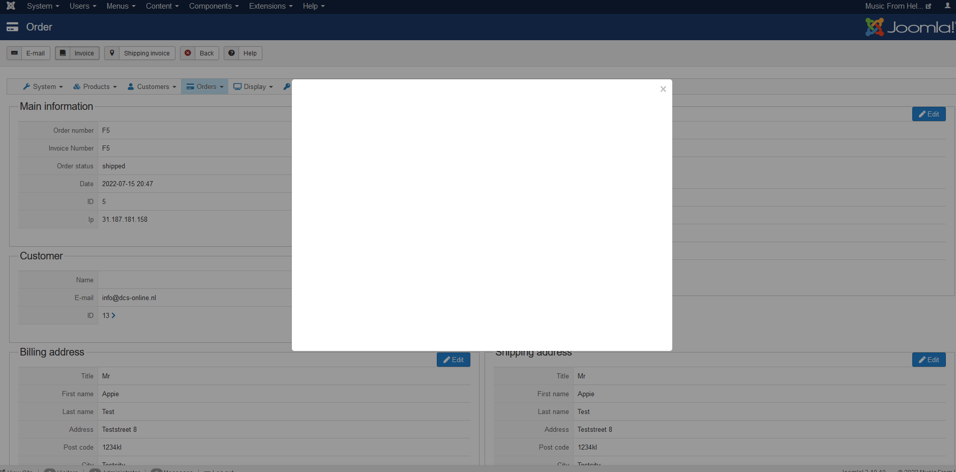

The pdf invoice plugin does nor work on PHP 8.0 and 8,1
I just got a white box were normally is the invoice. not a pop-up with the pdf invoice.
If I change back to PHP7.4 it works as supposed too. Or If I shut down the plugin I am getting the invoice with comes with Hikashop it self

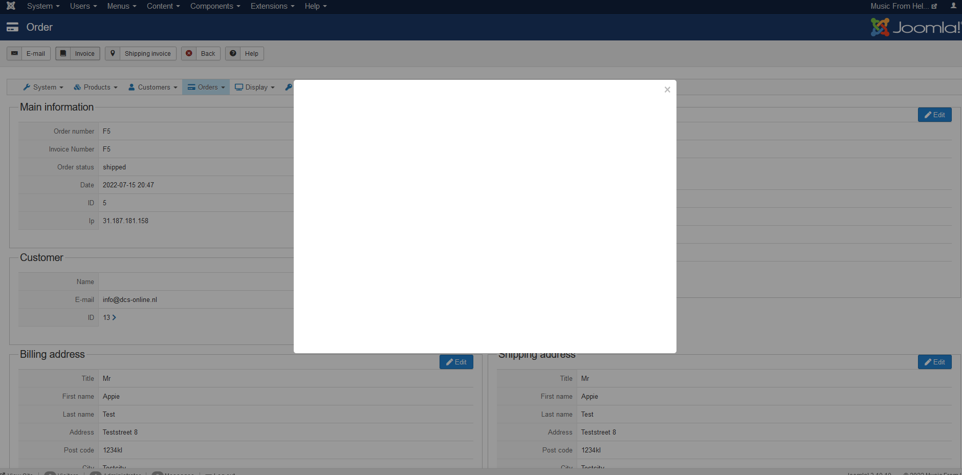

This means you're using an old version of the PDF invoice plugin.
Download its install package on our website via the same link you used when you first downloaded it in order to get the latest version install package. Then, install it on your website via the Joomla extensions installer and it should work fine.
