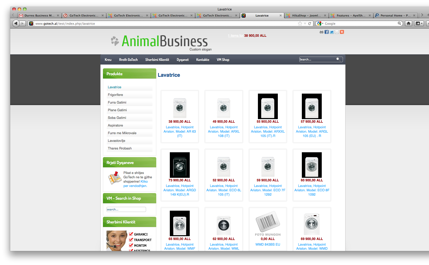

  • Posts: 14
12 years 2 months ago #36351
www.gotech.al/test this is the url. i can give you administrator access if you want.
(in the left you have the shop categories in order to add products to the cart. top-right is the cart)

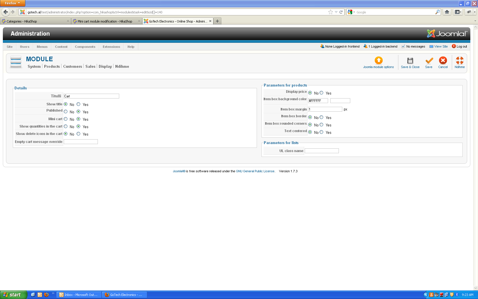

  • Posts: 81378
  • Thank you received: 13037
12 years 2 months ago #36399
Could you do a screenshot of your cart module's hikashop options screen ?
  • Posts: 14
12 years 2 months ago #36422
have i attached correctly??

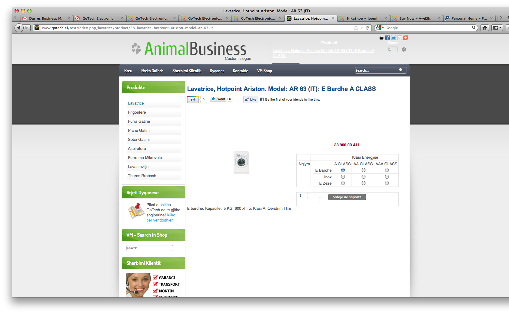

  • Posts: 14
12 years 2 months ago #36424
this is the screen after i navigate away
  • Posts: 81378
12 years 2 months ago #36456
No, I'm talking about a screenshot of the options of the cart module, not the front end of your shop.

  • Posts: 14
12 years 2 months ago #36483
i found out something that may help. When i click add to cart, i see the pop up asking pay now or turn to the shop. when i say pay now, the page is going to different url and during this process the page is refreshed and minicart is displayed correctly. when i say turn to the shop page is not refreshed and i see big cart.
