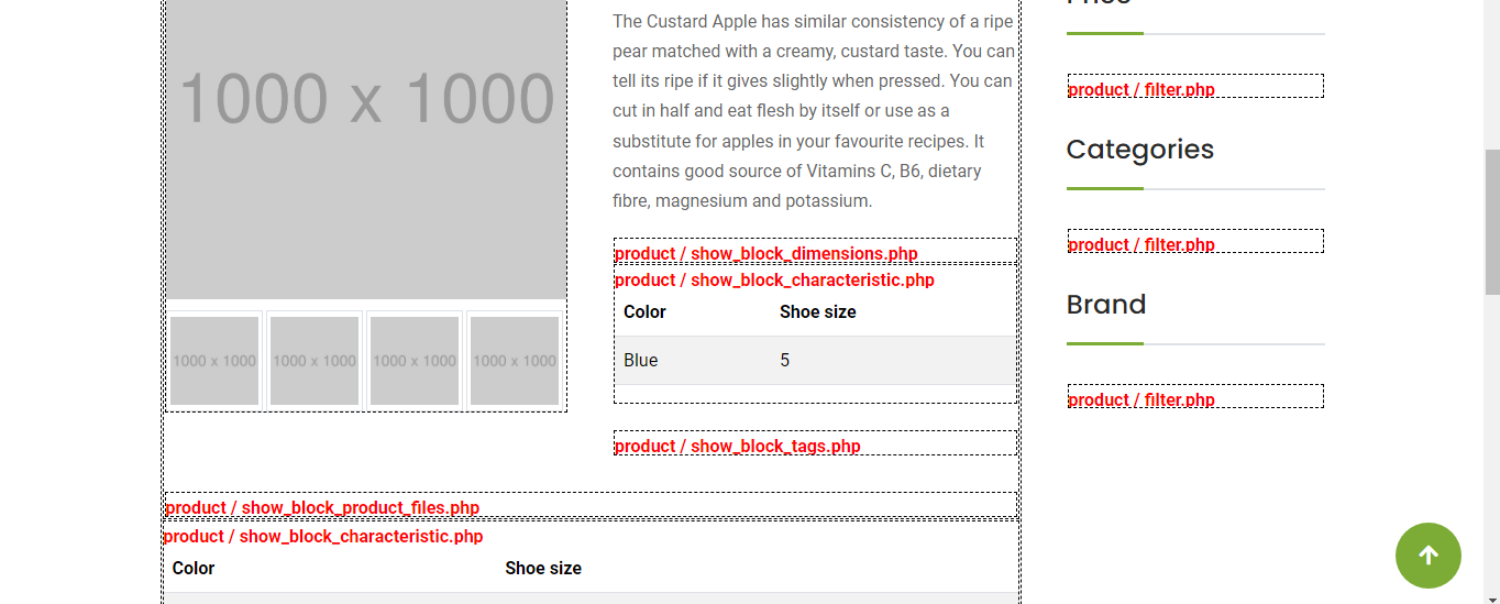

Hi at all, sorry for my english. I need help with a code without the form of hikashop. I start to create an ovverides of the page show_default for change the aspect of the product schedule, and for few i have complete my target. But, one of the code is out of the form and create a second table, i want erase this from the rest of the schedules.
I create a screenshoot with the error i see my charateristic table two times, and the second out of the form i need to erase. What is the file contain them?

Your screenshot indicates that you must have a view override of product / show_default.php where you load the show_block_characteristic.php sub view file twice.
So check the code of product / show_default.php and look for this code:
by searching for show_block_characteristic in the code. Normally, you should only have one instance of this. I'm suspecting you have it twice in there.
Code:
$this->setLayout('show_block_characteristic');
echo $this->loadTemplate();

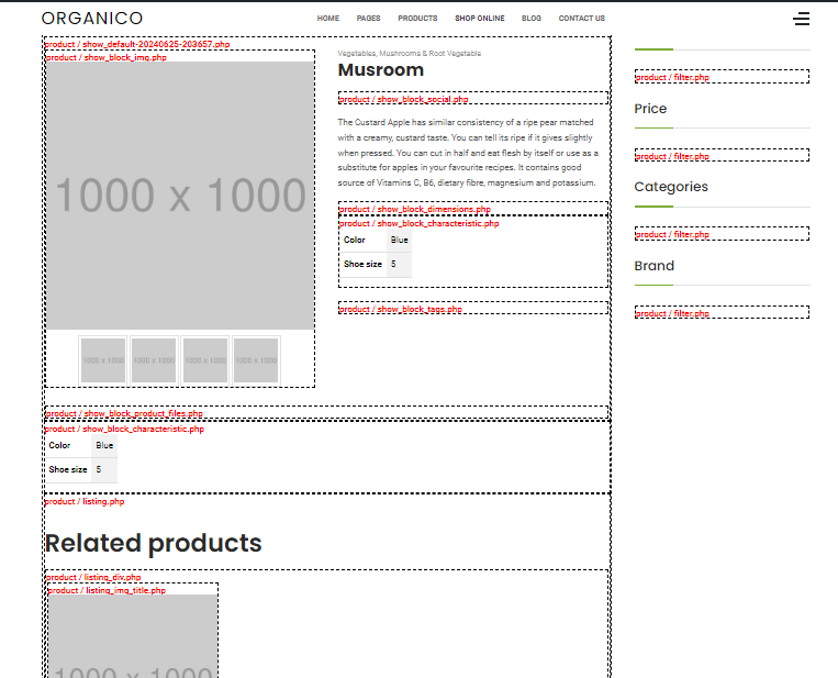

Could you provide a screenshot of all the page with the view files areas ? With your previous screenshot, it's not possible to be sure what is where as it's missing some of the view files used on the product page layout. So I can only guess, and my guess was wrong in my previous message...
