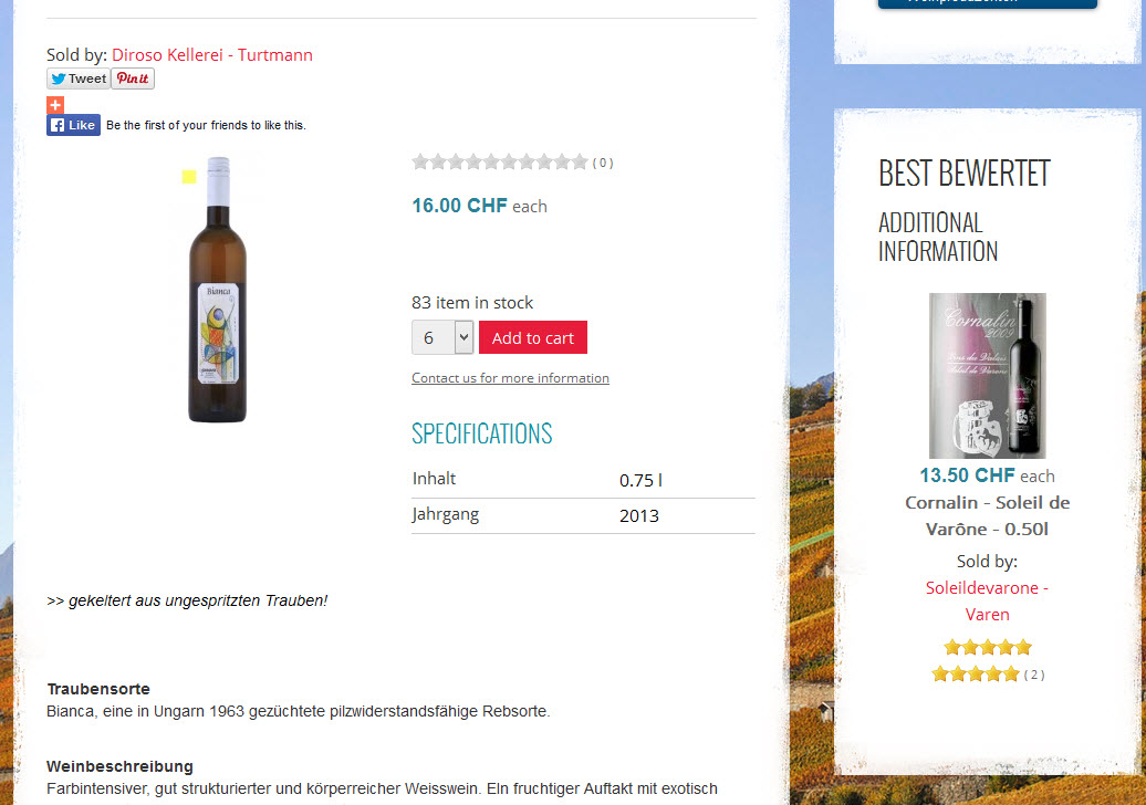

-- Joomla version -- : 3.3.6
-- PHP version -- : 5.5
-- Error-message(debug-mod must be tuned on) -- : multiple ratings
When i add 2 ore more modules like
- bestseller
- most rated
the rating stars are doubled or tripled, depending on how many modules i am using on the website.
Any idea how i can fix this?
Markus
- bestseller
- most rated
Markus

Markus
