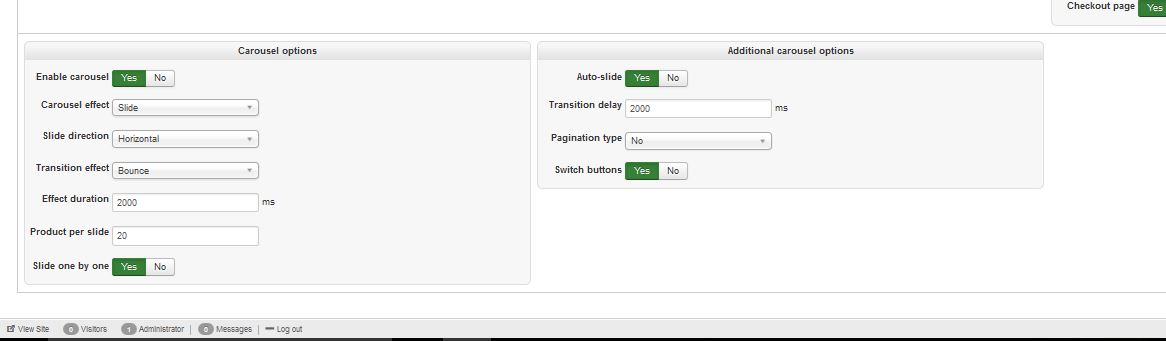

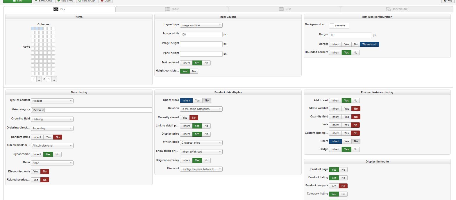

Sorry, I’m struggling with the carousel. It only shows the first 3 products and the navigators are not working and also the auto slide is not starting .
Any good idea?

You're displaying only 3 products in your configuration (very first setting).
And you have configured your carrousel to display 20 items per slide.
I think you should switch the values between the two settings.

thanks for the hint. It's a little bit hart to understand that via the rows you can define the total number of products to show. That was easier in the older version (and please update the examples) to version 3. That would be helpful.
