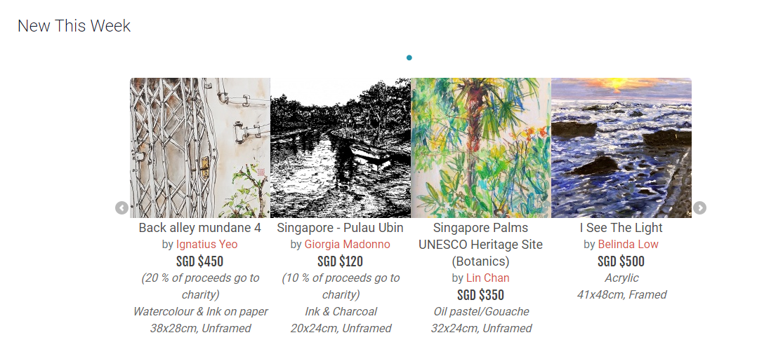

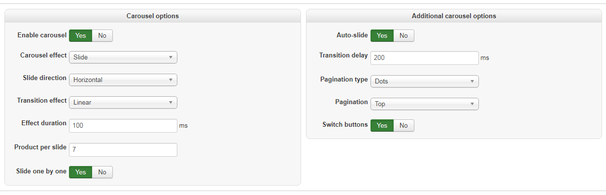

I've set up my slider parameters at the module section, but it's not sliding/moving at the front-end. What settings do I need to change?

I think I have figured it out by switching the columns and products per slide.
How do I now get the products to display the whole width, now it's all cramped together?

Now regarding the situation you have with the old carousel, it's hard to say. The screenshots you provided doesn't have all the settings of the module which also influence the way the carousel is generated (like the number of elments per row, or the margin.
If you can't activate the carousel setting / update your Hikashop and still want to find a solution with the old version, I would recommend that you first provide screenshots of all the settings under the "hikashop options" tab of the module.
