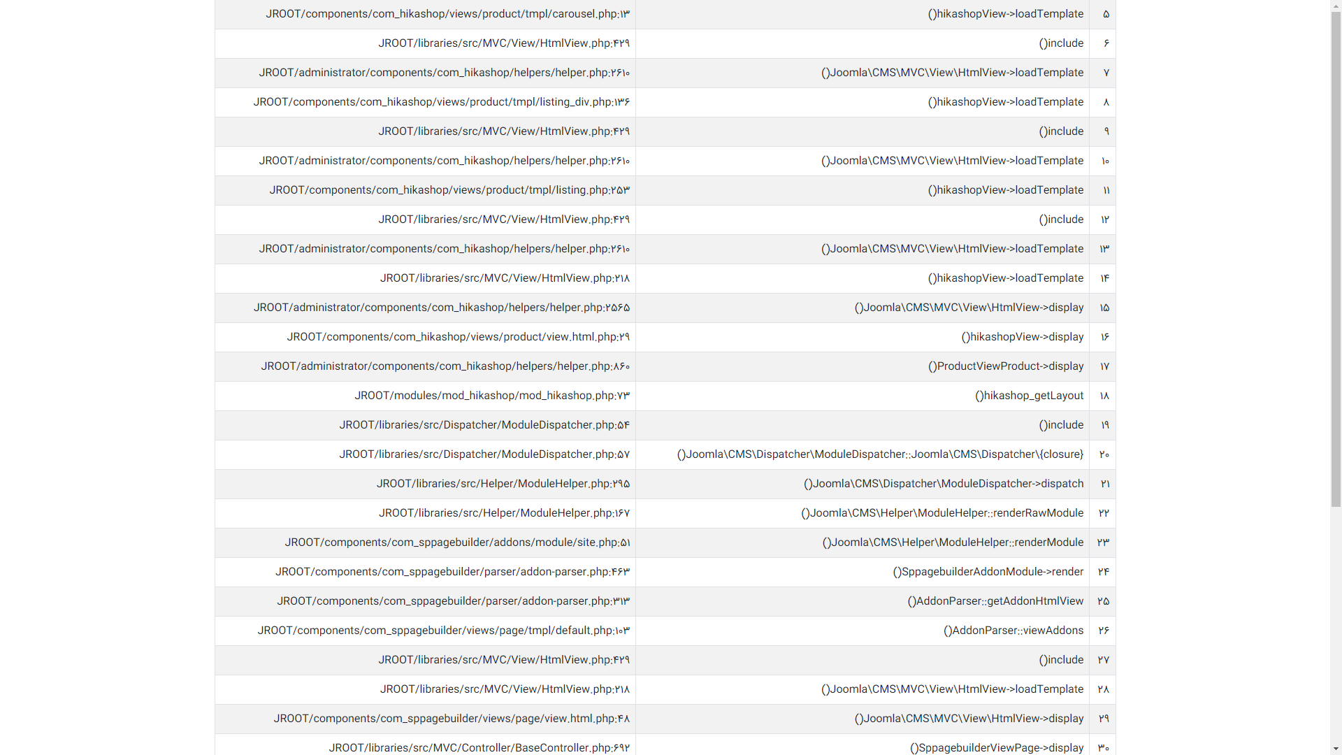

-- Joomla version -- : 4.0.3
-- PHP version -- : 7.4
-- Error-message(debug-mod must be tuned on) -- : 500
behavior::framework not found.
I get a 500 behavior::framework not found error when I select the carousel display option in the hikashop content module.
The debug mode image was also attached.
thank you very much.
5 years 1 week ago #335727
by nicolas
Replied by nicolas on topic 500 behavior::framework not found in div slider
I can't read the numbers on your screenshot.
However, I suppose that the issue is that you have the legacy carousel system activated under the advanced tab of the HikaShop configuration.
Please turn that off as the legacy carousel is not compatible with Joomla 4.

5 years 1 week ago #335735
by farzadfarzad
Replied by farzadfarzad on topic 500 behavior::framework not found in div slider
Thank you very very much.
You said right. The problem was the same.
