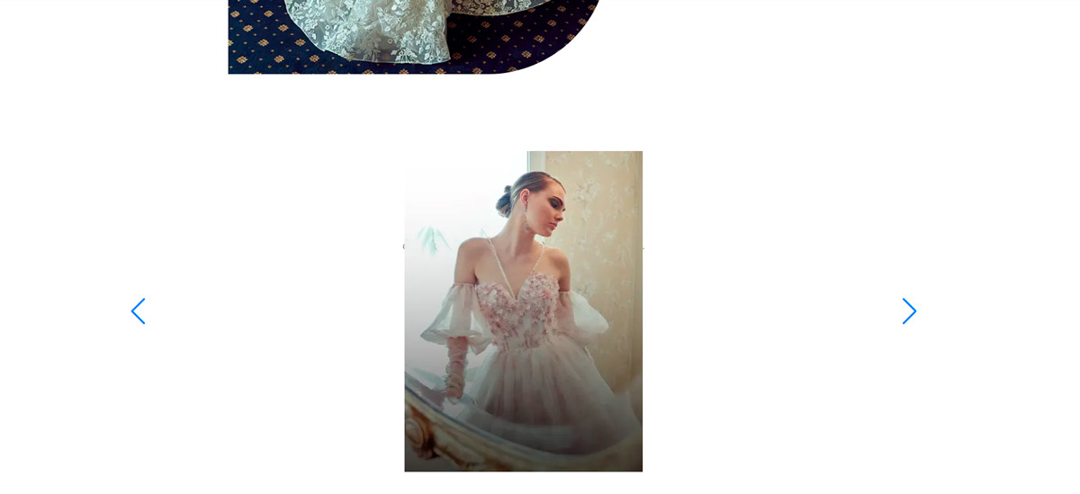

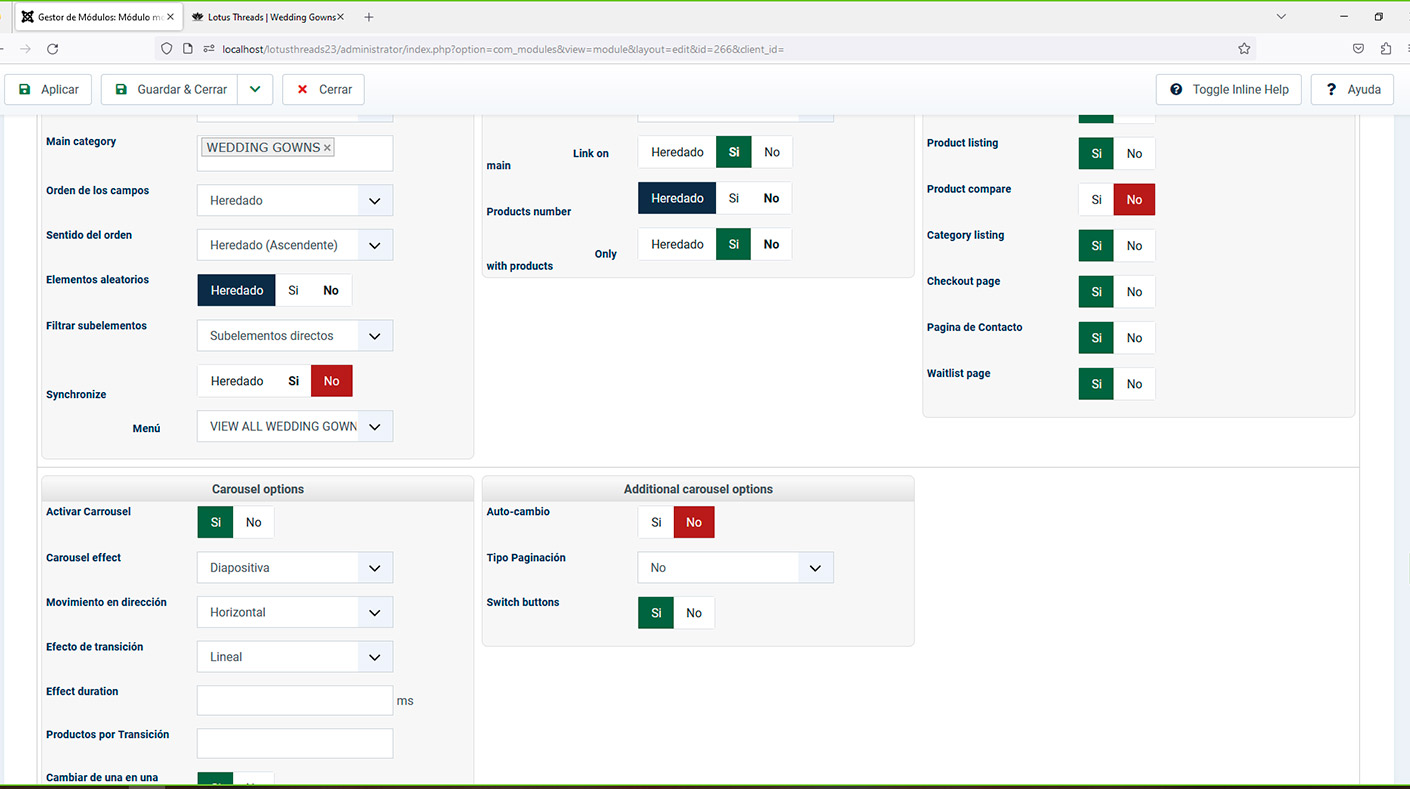

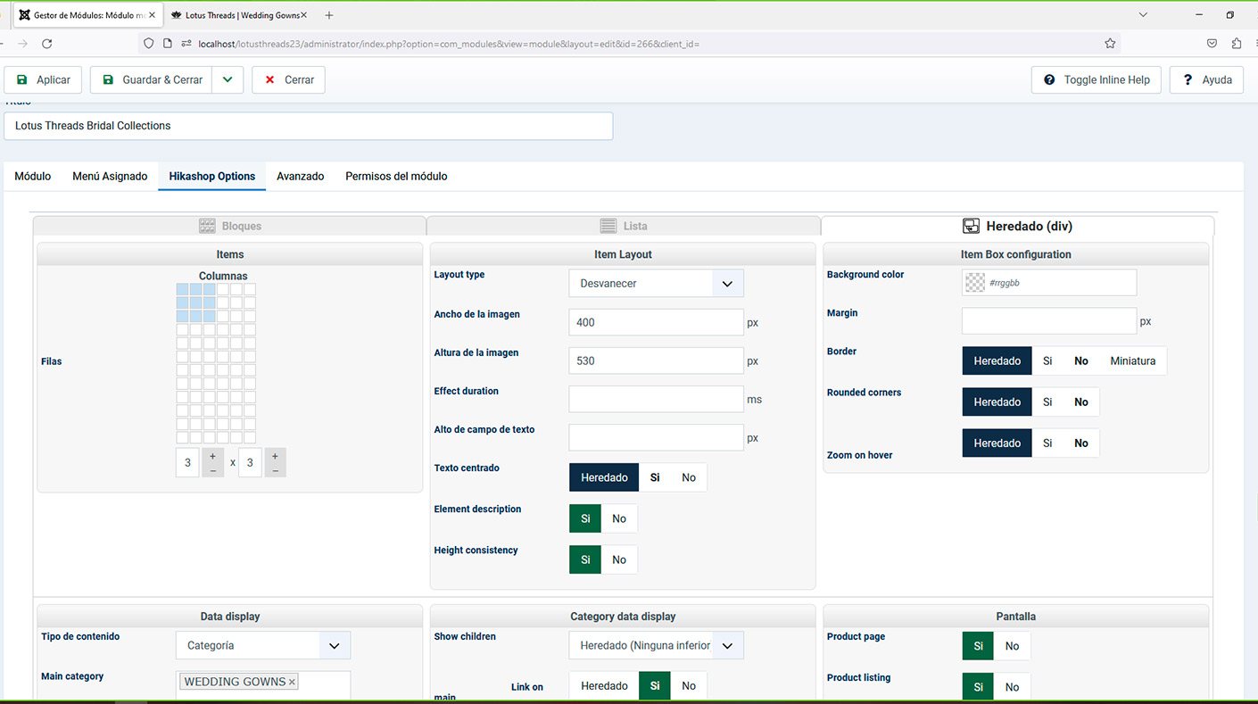

After the latest hikashop update, the Carousel Switch buttons do not work when the content is categories.
Also, when the page loads only one slide appears, it does not show the three that are configured. Refreshing the browser does not update the view, I have to navigate within the website and return for it to load.

We added patches specifically around the Carousel, can you update to see if that solves your problem?
Other you can try is to process a test with a default template in order to see if that change something to your issue?
If nothing, I'm afraid that we will need to see the issue directly in your website.
