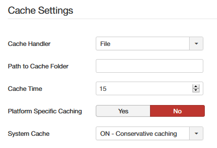

I've had issues with my cart not updating properly when I had Joomla caching enabled, so I've run my site with caching disabled for a while. Unfortunately this is causing the site to be quite slow and I would like to use caching again. All I can find about using caching is that Hikashop should work well with the default Joomla caching settings, but I can't find any more specific information in the Hikashop documentation.
I have now set my Joomla caching (under System > Global Configuration > Cache Settings) to ON - Conservative Caching. Is this the correct way to do it so that Hikashop components will be cached correctly and do not cause updating problems? Should the Progressive Caching setting also work?
The default Joomla chaching settings are quite limited. Are there any more advanced chache plugins for Joomla that work well with Hikashop?

by nicolas
Replied by nicolas on topic Hikashop checkout and Joomla Caching
Yes, you can have conservative caching.
Full caching is problematic for the refresh of the cart.
But even so, years ago we made improvements to better handle caching.
Besides Joomla caching, I know of jotCache for Joomla: extensions.joomla.org/extension/jotcache/
So you could have a look into it.

Thank you for your answer. I will look into the possibilities of JotCache. Do you know if this works well with Hikashop straight out of the box?

I've never used it myself. So I couldn't say. I just know that several of our users were using HikaShop with jotCache on their website without problems.
