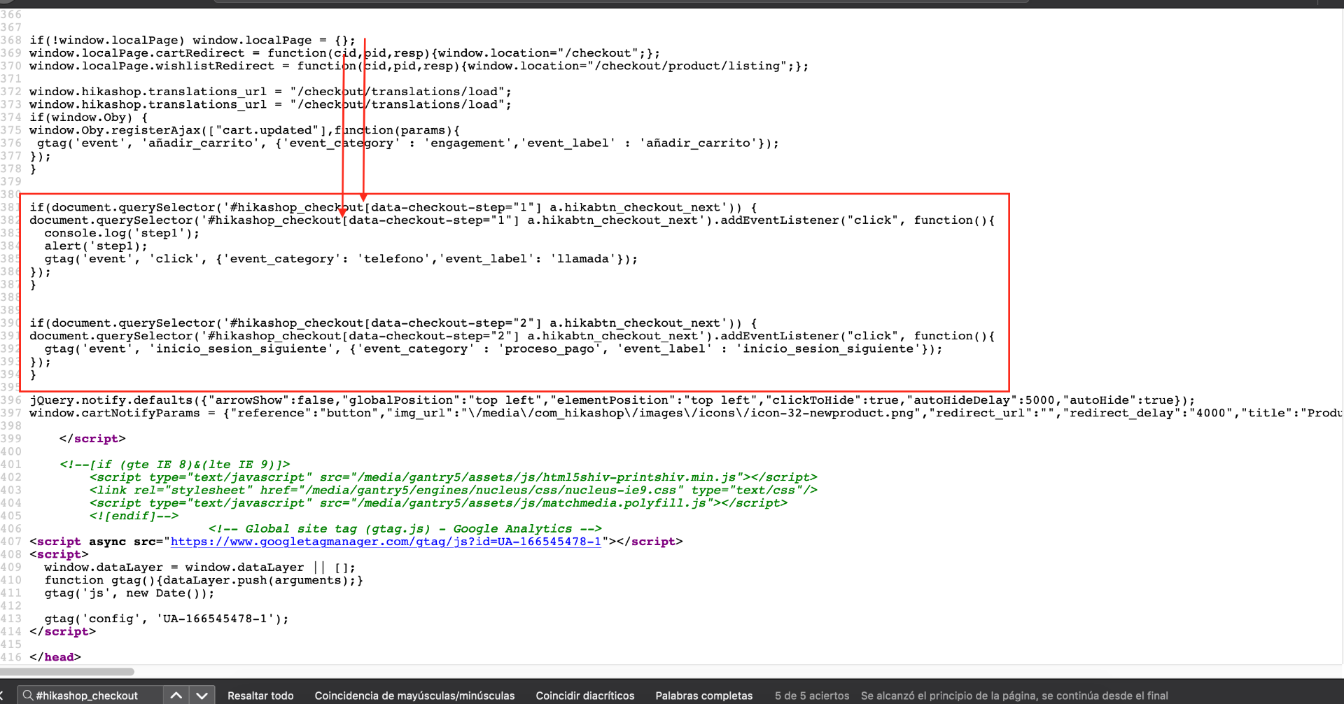

We are starting to implement google analytics on the site, for which the marketing agency asks me to icluid certain JS codes on the buttons of the purchase process, the "next" button of the purchase process. With JavaScript, the click event of the link or button is captured, but in order to capture it, the event uses the css class or the element id. It happens that all the "next" buttons, from each step of the purchase process are the same, same css class and same item id.
My query is, do I have any way that each "next" button of the purchase process has at least one extra class of css different for each one, so that I can capture each click that the user gives and in this way Know how many begin the purchase process, how much they abandon the purchase process and how many finish it.

There is not one different class in each step directly on the next button.
However, you can do it without that.
Instead using
$("a.hikabtn_checkout_next")
you can use:
$('#hikashop_checkout[data-checkout-step="1"] a.hikabtn_checkout_next')
and that way you'll be able to add your code specifically for the button on the first step (and so you repeat the code for each step changing the "1").

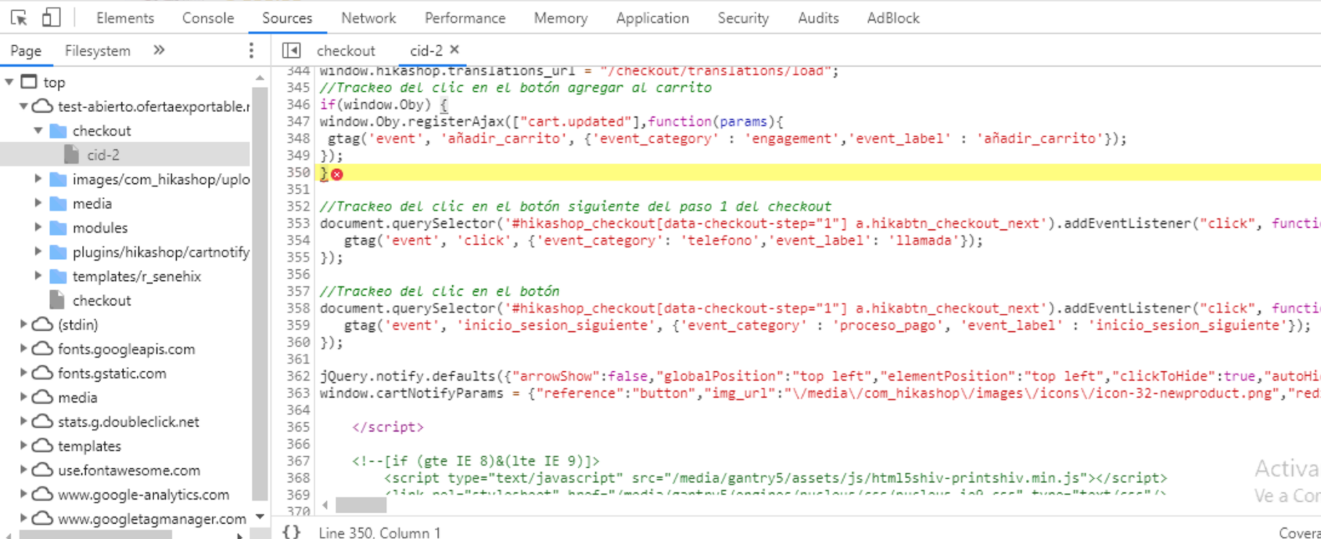

  • Posts: 127
6 years 3 months ago #319374
Hello

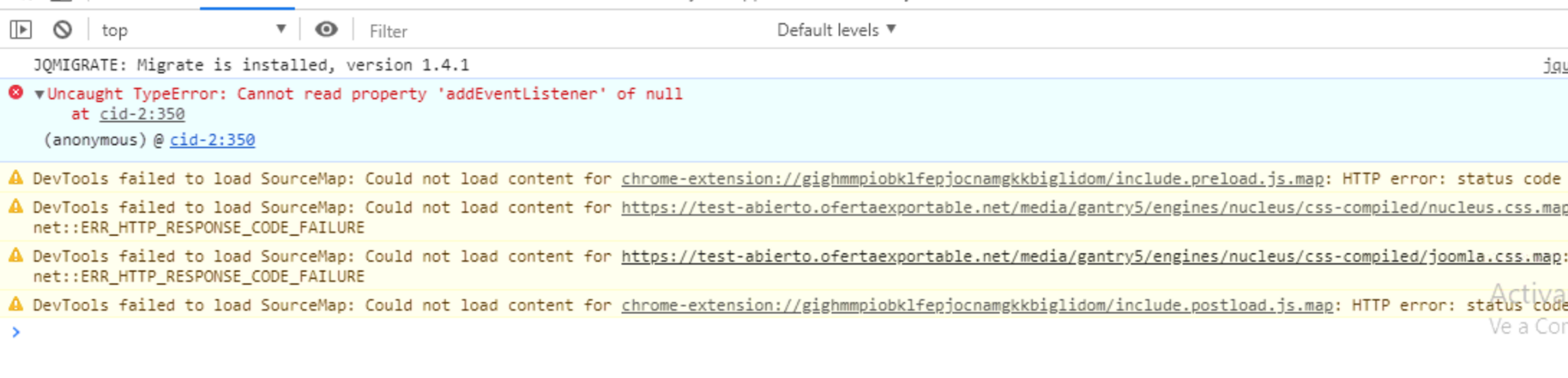

Well I followed your directions but it gives me another error
Uncaught TypeError: Cannot read property 'addEventListener' of null
     at cid-2: 350
I really don't know what the mistake will be, I appreciate your help.
Thank you very much, greetings!
  • Posts: 86116
  • Thank you received: 14211
6 years 3 months ago #319376
Well yes, you need to add a check as that button won't be on all the pages of your website.
So it should be like this:
if(document.querySelector('#hikashop_checkout[data-checkout-step="1"] a.hikabtn_checkout_next')) {
document.querySelector('#hikashop_checkout[data-checkout-step="1"] a.hikabtn_checkout_next').addEventListener("click", function(){
 // your javascript code
  • Posts: 127

You are helping me a lot with this the issue of event tracking, the conflict that was generated with the checkout buttons has already been corrected, but I cannot get the tracking to work, I added a console.log() and an alert() to the JS code , to see if the function is executed, but the alert is not displayed and the message is not written in the console, it would seem that JS cannot find the link. I even tried the selectors like this, but it didn't work.
#hikashop_checkout [data-checkout-step = "1"] > a.hikabtn_checkout_next
If you have any more ideas that can help me, I will be very grateful
