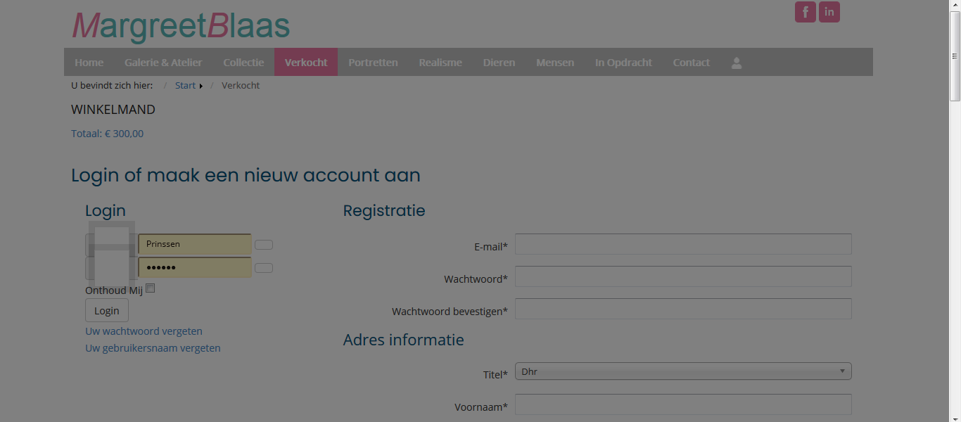

I made my Terms & Conditions article and in my checkout settings I assigned it to this article.
When ik place an order on the site, the article will not show but instead of this, there will be a gray transparent overlay on my screen.
(see screenshot)
Could anyone tell me what is going wrong?

6 years 2 months ago - 6 years 2 months ago #322226
by Philip
Replied by Philip on topic Gray transparent overlay on browsers window
I process some tests directly on your website, and we were able to see your issue but not to get clues on your current issue.
Can you process some tests with a default template like ProtoStar to see if that change something to your issue.
If it happen with a default template like Protostar then provide these relatives elements :
- Your terms and condition article setting screenshot
- Your checkout Workflow screenshot
Hope this will help us to progress on your subject.

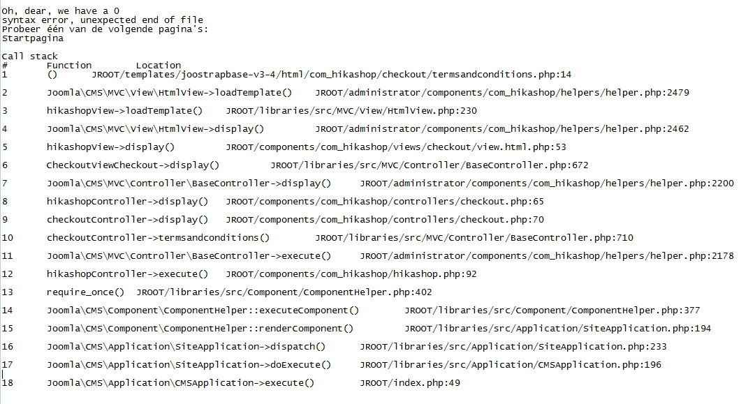

6 years 2 months ago - 6 years 2 months ago #322291
by Philip
Then you have to contact your template creator because after a quick analyze it seems that something is that leads to this new issue.
There are an Jquery error that come from Joopstrapbase that leads to a 500 error, means that your terms & conditions isn't find.
Can you activate the error reporting et set the debug mode to developement error, then have a look of information displayed.
Awaiting a screenhot of this information to be able to progress on your subject.
Last edit: 6 years 2 months ago by Philip.

6 years 2 months ago - 6 years 2 months ago #322315
by Philip
Have a look on the first line of your call stack :
"JROOT/templates/joostrapbase-v3-4/html/com_hikashop/checkout/termsandconditions.php:14"
This seems to indicate that you have an override, created by some or by your template.
Maybe this the root issue ? Maybe the HikaShop override view is from an too old HikaShop view ?
Anyway go to this file, and rename it like "termsandconditions0", and test to see if that solve your issue.
And if not, once again provide the error details like you already did.
