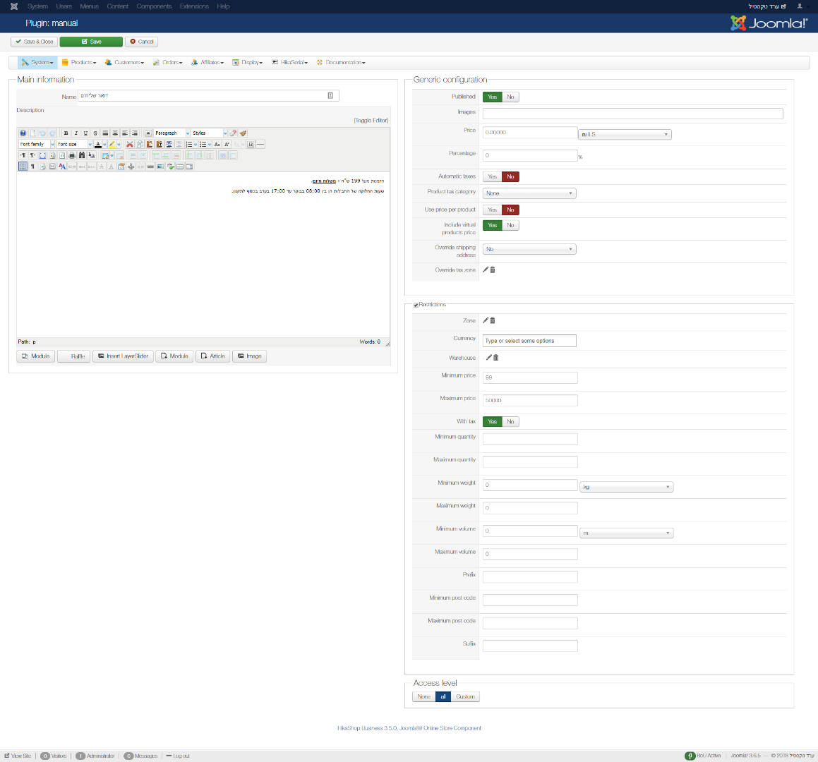

Can you show us screenshots of how you configured:
- Your shipping method
- Products prices that were added to your cart
- Your coupon used through your checkout workflow

Hello Mohamed,
Yes, I've setup Hikashop 3.5.0.
I've attached the screenshots you've requested:
- Your shipping method - Attached.
- Products prices that were added to your cart - Two products, 55 NIS each and we've setup a 1+1 coupon with AWO-Coupons so the price dropped to 55 NIS.
- Your coupon used through your checkout workflow - AWO-Coupon
I've setup a copy of the website on a test environment. Would you like me to PM you the credentials with the information you've requested so you can check it for yourself?

8 years 2 months ago #295134
by Mohamed Thelji
Replied by Mohamed Thelji on topic Shipment method after coupon usage
I just tested it again using the same configuration and an Hikashop coupon and it worked fine.
The best solution will probably be to directly contact Awo-coupon's developer team as you are having an issue when configuring a coupon using their extension.

Replied by theguy on topic Shipment method after coupon usage
Hi Mohamed,
You are right. Just tested the system with a clean Joomla, Hikashop and Awo-Coupons and the problem is indeed with AWO-Coupons.
I will contact them once again.
