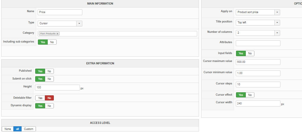

About issue 1: I have set a price filter with attached settings. In the frontend when choosing a price by moving the slider/cursor, the filtering is performed correctly but the slider returns to its previous position.

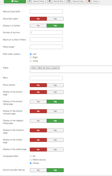

About issue 2: A filter module is set to be always Collapsable. It opens when you click on it but as soon as you use a filter, it closes (happens with whatever filter). I think it should stay open until someone clicks on it to close it.
3. Attached the filter settings from issue 1 and filter module settings from issue 2
