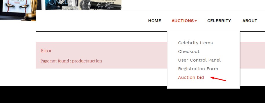

Hey!
The default Hikashop menu has a link to the Auction Bid. When clicking on the link, we get to a non-existent page.

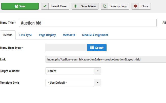

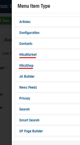

Can you show us screenshots of how you configured your Joomla "Auction Bid" menu (especially the "Menu Item Type" option) so that we can reproduce it on our end ? Thank you !

5 years 4 months ago #332505
by bstars
Replied by bstars on topic Error HikaAuction
Less
More
- Posts: 12953
- Thank you received: 1778
5 years 4 months ago #332523
by Mohamed Thelji
Replied by Mohamed Thelji on topic Error HikaAuction
Thanks for the information, the "Auction bid" menu is actually used for its Item id which will enable us to correctly display Auction pages.
So that menu shouldn't be displayed through your front-end as it's only used through HikaAuction's code.
Kind regards,
Mohamed.
Kind regards,
Mohamed.
