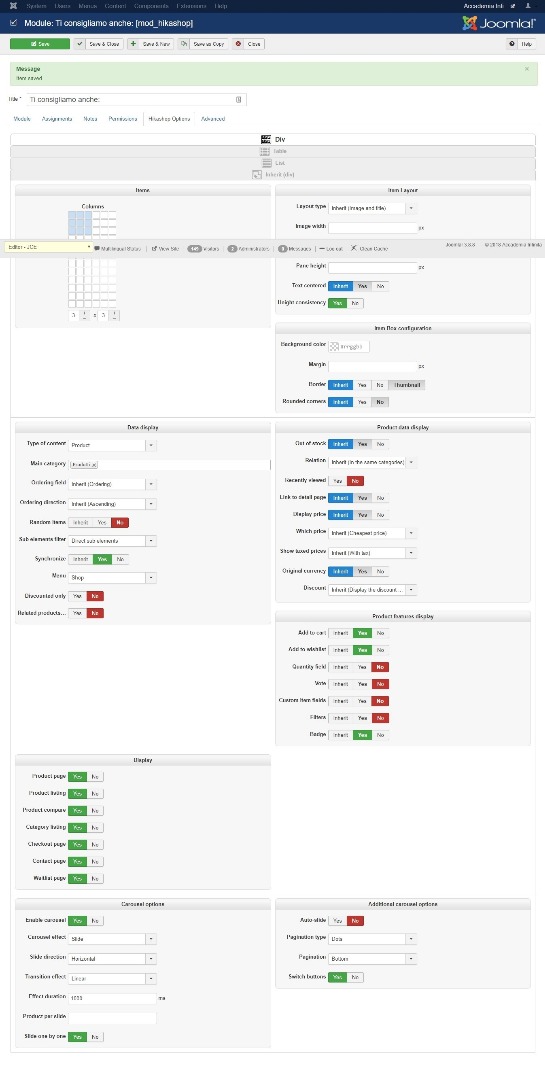

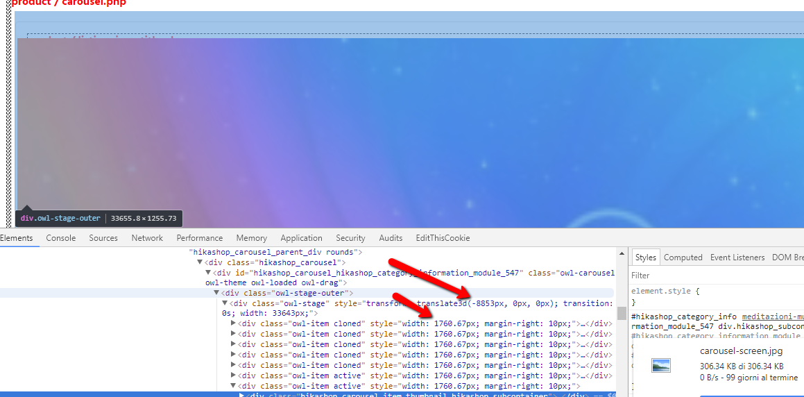

I attach what I see when inspecting the cose and this module configs.
