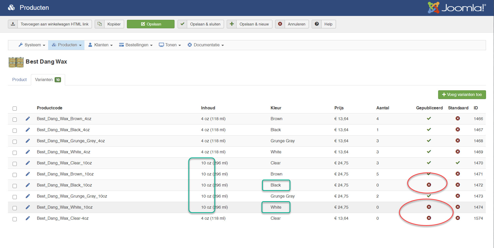

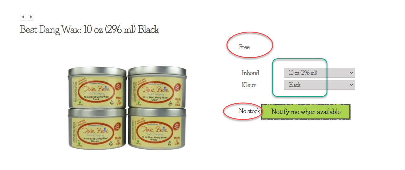

Hi Hikashop team,
We have a strange issue with characteristics.
As you can see we unpublished 3 variants.
But why is the 10 oz stil visible and also for Free?
Hope you can give us a hint.
Kind regards,
Lumiga

6 years 3 months ago #320561
by nicolas
Replied by nicolas on topic Strange effect with characteristics
That's because the system is not dynamically refreshing the dropdowns.
If you want that to happen, you can activate the "Characteristics dynamic display" setting of the HikaShop configuration.
In that case, you won't be able to select an unpublished variant and thus you won't have the problem.
