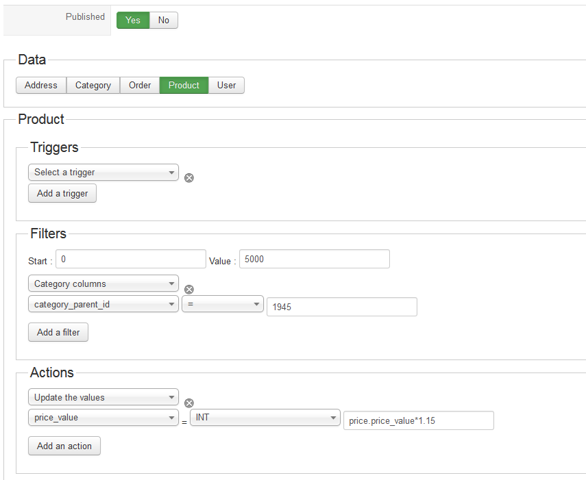

Hi After running this mass action (attached) hikashop has just changed the value of all the products to £0.00 rather than increase the price by 15%. Please can you advise. This on hikashop v2.2.3

This is because the type of value is not correct, you have selected "INT" and you should select "OPERATION" in the Action part of the mass action.

I see, I made 40 of these and the one i run was the only one with that mistake thank you.
