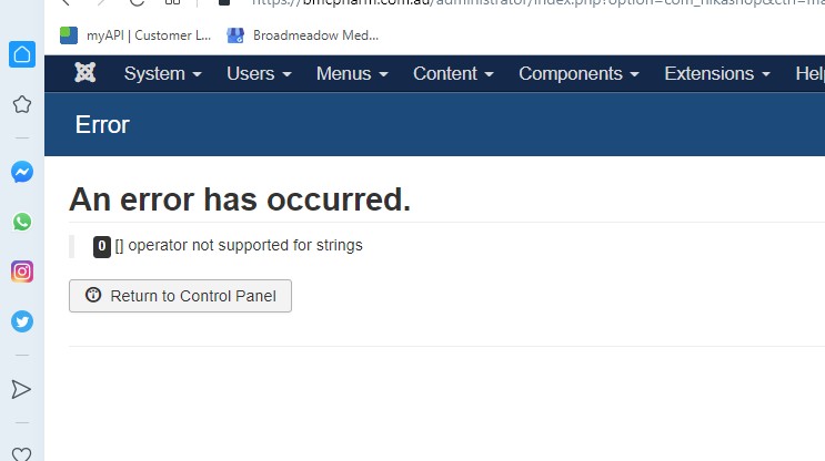

5 years 11 months ago - 5 years 11 months ago #324930 by smithshop123
the 403 error remained for our cpanel based site saying 'access forbidden'. I didn't see any debugging info. I did select 500 items.
A different error occurred on Cloudaccess.net. i used 500 items with it, The outcome is below. I've also attached the error message from trying to run the sql query via myphpadmin.
Regards.

5 years 11 months ago - 5 years 11 months ago #324931 by nicolas
Replied by nicolas on topic Add sort price description
That error indicates that what was written in the input field is invalid.
However, I just tried to run the same mass action with the text "concat(product.product_description,product.product_sort_price)" in the input field and it worked just fine.
So either it's a bug of the 4.3.0 and updating would help, or you made a typo in the input field.
And regarding the error with the MySQL query, it's because you didn't change #__ by the table prefix of your joomla tables. That prefix, which is apparently jos_ on your website, is normally generated dynamically when you install Joomla and thus it's a convention in the Joomla community to write #__ instead as Joomla's MySQL interface automatically replaces #__ by the table prefix you can see in your Joomla configuration when you send MySQL queries through it.

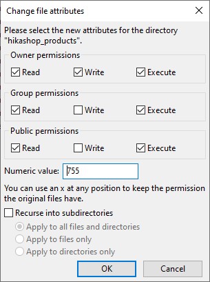

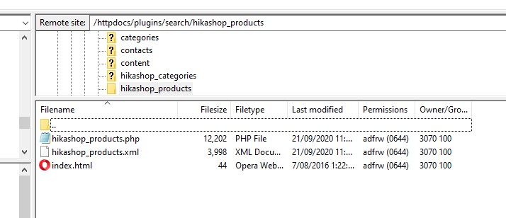

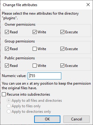

5 years 11 months ago - 5 years 11 months ago #325081 by smithshop123
I'm able to set the permission. What do you recommend?
With the attachment. It is being uploaded via the cron which has the function to convert the names of columns. However,
I'll double check if the value are getting through.
Ian, Stu
edit:
I've got ;
  • plugins folder permission 755
    search folder permissions 755
    hikashop_products folder permissions 755
    hikashop_products.php file permissions at 644
Let me know what to change it to. How high up and if I should change it recursively.
Thanks,
Ian and Stu
Last edit: 5 years 11 months ago by smithshop123. Reason: Adding in the permissions information
More
5 years 11 months ago #325094 by nicolas
The correct permissions to set to your files and folders depends on how your hosting server is configured.
If your FTP user is the same as the web server user, then you would use 755 and 644 or even 700 and 600.
But if the users are different, you might have to set the permissions to 777 OR to change the owner on the files/folders.
If a file is uploaded by the user "FTP" with the permissions 755, then only the user "FTP" has the right to modify the file. If later on the user "web server" wants to update the file, it will be denied.
In that case, the best would be to change the owner to "web server" so that you can keep permissions of 755.
But the quick and dirty move is to set the permissions to 777 so that you're sure the "web server" user will be able to update the file.

5 years 11 months ago - 5 years 11 months ago #325114 by smithshop123
let me know what folders/files to change to 777 to ensure the successful update..The current setting for folders is 655 and it is 644 for files.I only ask because there are a lot of files, Only some of which can be updated recursively via ftp.
Ian and Stu
p.s. I'm also happy to PM you the ftp and admin access to undertake the process
More
5 years 11 months ago #325119 by nicolas
Since, your issue is with the products search plugin, you can just do it for the files in the /plugins/search/hikashop_products folder before installing HikaShop again.
The following user(s) said Thank You: smithshop123
