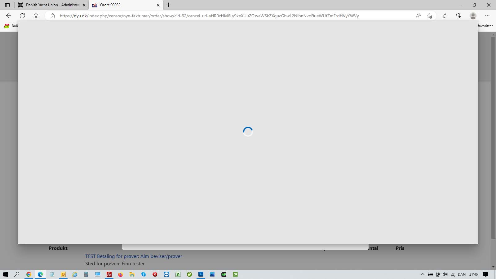

I have the same problem
Joomla 4.2.6
Hikashop Business 4.7.0
PDF plogin 1.1.4
PHP 8
Nothing is attached to the emails to customer or administrator and same problem with an empty popup window where nothing happens.....
Considering if the attach invoice as PDF to confirmed orders are working at all?
Can someone maybe help me? Our customers are complaining that they dont get any PDF invoices after we swithed from Virtuemart to Hikashop....

3 years 8 months ago #348433
by nicolas
Replied by nicolas on topic Error printing invoice on the frontend
The plugin is working fine and is being used by many.
Could you provide a screenshot of the settings of the plugin ?
Are you able to get the invoice from the backend order details page with the "invoice" button ? That's the first thing to try.
Regarding your screenshot, it looks like the browser has troubles displaying the print prompt. It's not clear whether it is related to the plugin or not. If you disable the PDF invoice plugin, do you still have the same issue ? If so, it would confirm it is not related to the plugin. If not, it means the plugin is providing the PDF but the PDF reader has problems reading it. It could either be a problem with the PDF reader or with the PDF file generation.
