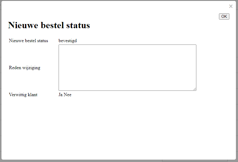

-- Error-message(debug-mod must be tuned on) -- : The display is not as it was with php version 7.4 can't ok on change status from confimd to deliverd and visaversa
after updating php version to 8.0 confirmation window does not show as before and OK can't be pressed

We don't have the problem on our end.
It seems as if the HikaShop CSS is not loaded in the popup for some reason on your end. Could you provide a backend access so that we could look at the situation ?

When looking at the HTML of the popup, I didn't see the HTML editor for the email preview in the popup (which appears if you activate the user notification yes/no). So I displayed again the popup after activating temporarily the debug and error reporting in your Joomla configuration and I got that error:
In fact, you have the same issue when editing a product, or editing a Joomla article (normal since they also use the HTML editor).
So I suppose you didn't update JCE. Do it and it should fix the problem, or you can switch to TinyMCE.
Thank you for the access.
As you can see the error comes from JCE. The error message means that your version of JCE doesn't support PHP8.Fatal error: Array and string offset access syntax with curly braces is no longer supported in public_html/components/com_jce/editor/libraries/classes/browser.php on line 270
