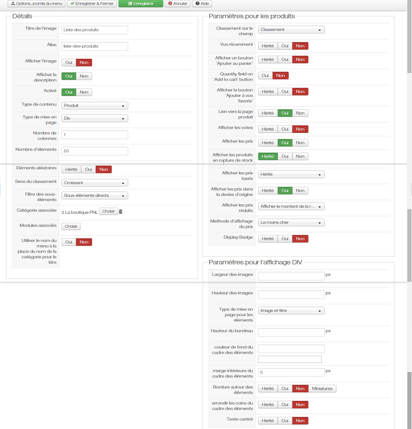

11 years 7 months ago #191344
by Sciuridae
Replied by Sciuridae on topic Empty category on frontend
I do it like this
11 years 7 months ago #191405
by nicolas
Replied by nicolas on topic Empty category on frontend
This screenshot isn't from the options page of the menu item of the link you gave.
The link you gave has the alias "Boutique-pnl" while the one on your screenshot has the alias "liste-des-produits".
Check the Boutique-pnl menu item options. That's where you have the issue.

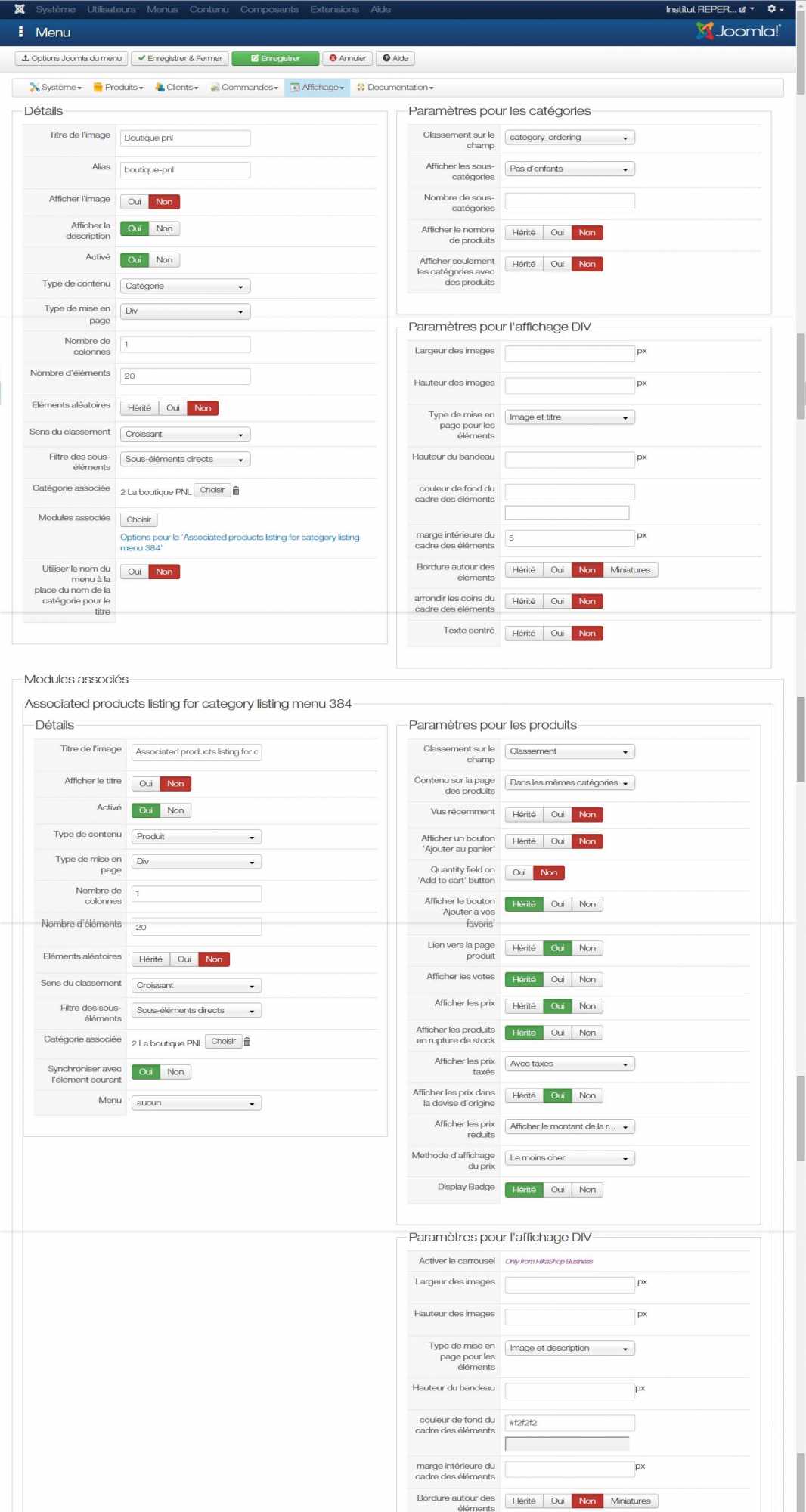

11 years 7 months ago #191473
by Sciuridae
this menu have disappeared after the upgrade, I have recreate it but still see nothing inside my category.
maybe the menu is not link anymore to the category ?
11 years 7 months ago #191605
by nicolas
The menu is configured properly as far as I can see.
So it's not from the HikaShop options of the menu.
It could be an issue with the joomla settings of the module/menu.
But if it was working before the update, then it's probably something else.
Maybe something with the SEF settings of the HikaShop configuration.
Can you make sure that the "Activate smaller URLs" option is activated in the HikaShop configuration ?
Also, if you turn on the "error reporting" and "debug mode" options of the Joomla configuration, do you get any errors ?
