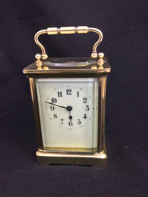

I am in the process of creating a site and seem to have an issue with images that are from an iPhone. The image should be in portrait mode as per attached but after uploading it is rotated to landscape. I batch saved them in Photoshop and they display as expected.
One suggestion is that iPhones save dimension data in reverse and this is what might be causing the images to rotate. I can batch change the images via photoshop but my client will want to just upload them as he adds products.

The first image is from the iPhone.
