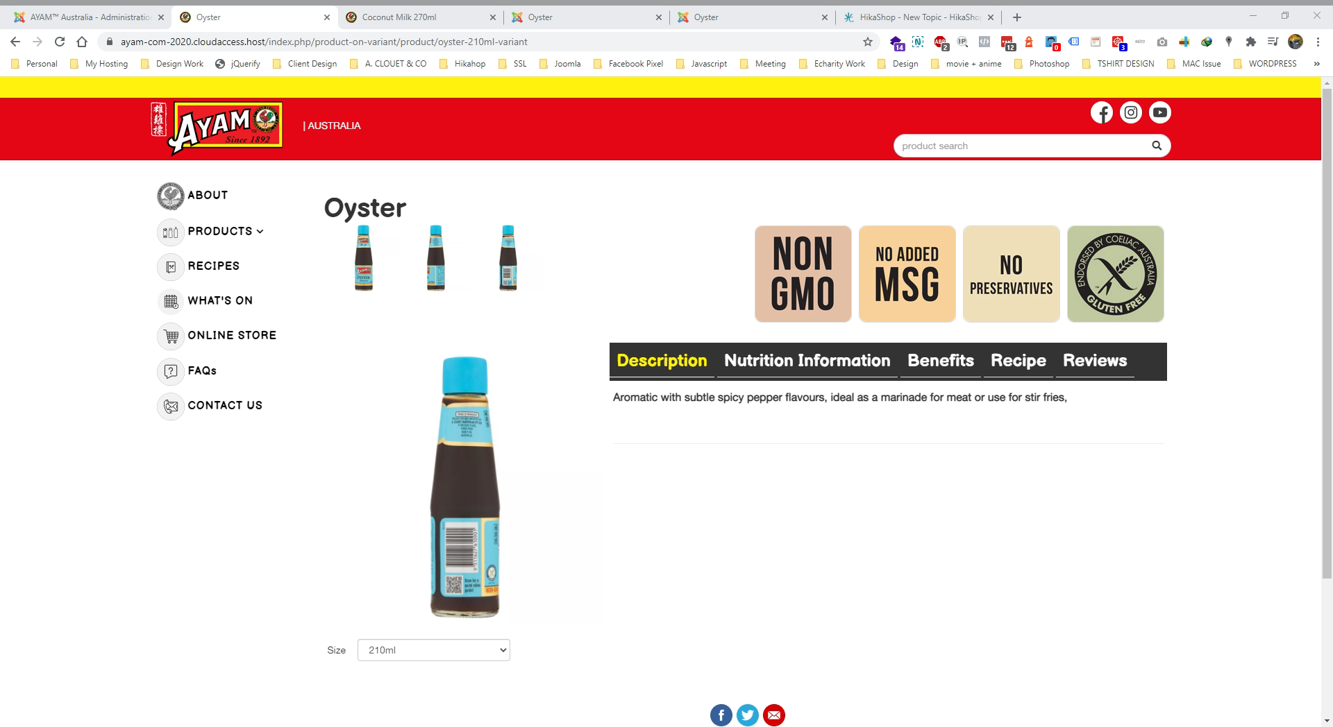

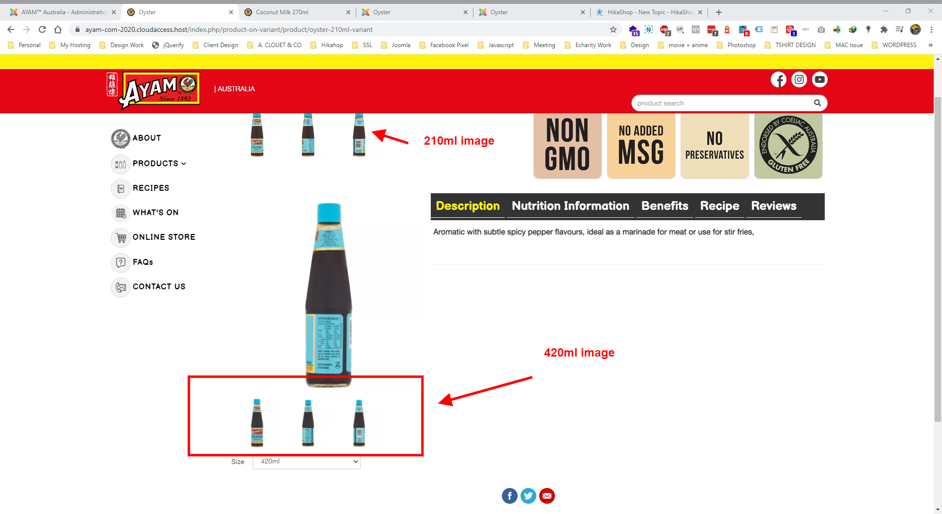

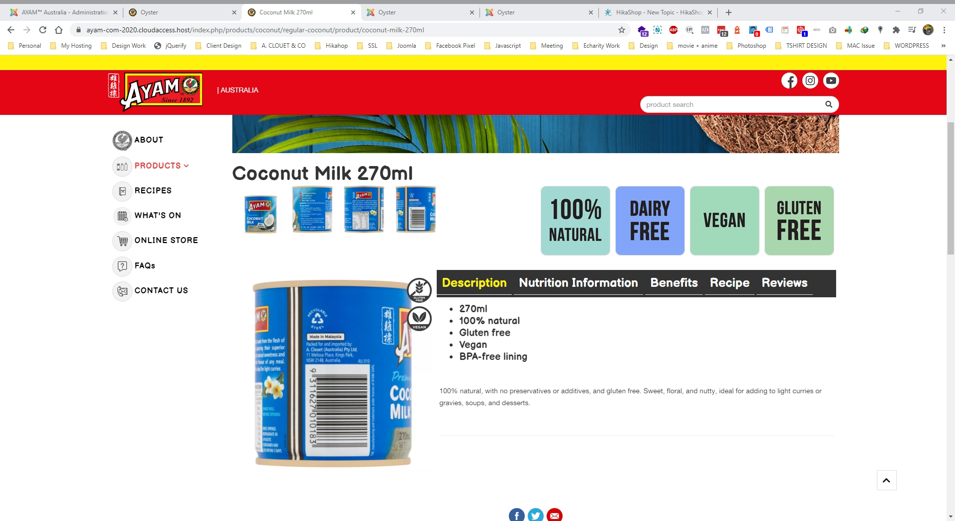

I have some modification on product/show_tabular.php file to achieve view like this.
Link to the page as below : Click Here
But i found out some issue when try to use product variant.
Link to the page as below : Product Variant Page

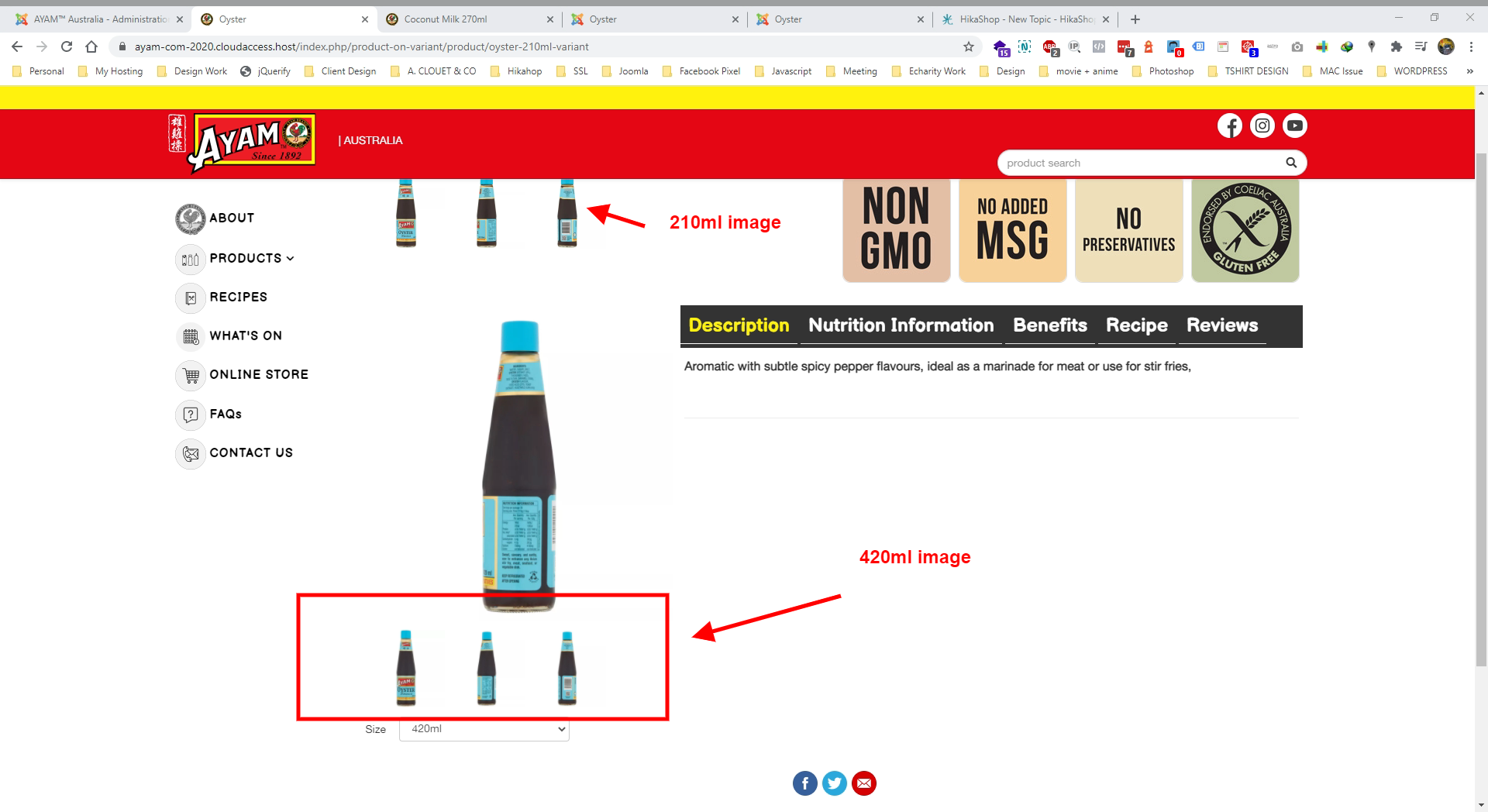

Variant for 420ml
How can i make when user change from 210ml to 420ml variant it load the small image on the top and replace the 210ml image?
The zip file are the file that are modified.
Can you help to check? Thanks.

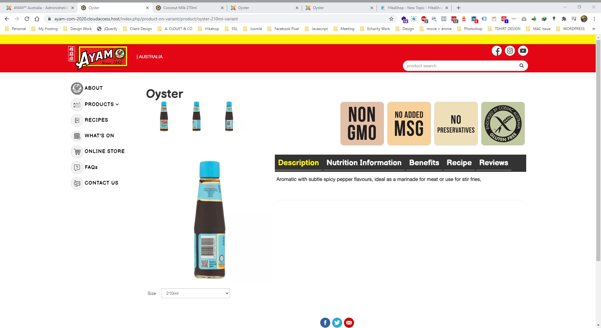

- Variant for 120ml
5 years 6 months ago - 5 years 6 months ago #330336
by Philip
Replied by Philip on topic Product Image

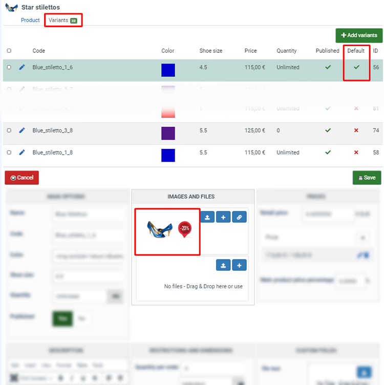

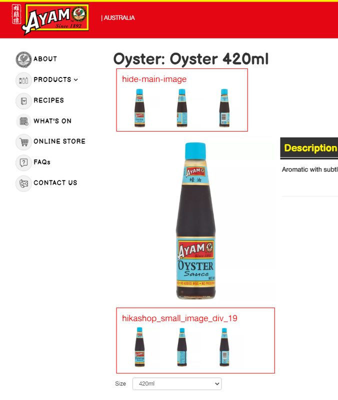

As a start please consider my screenshot :
As you can see on my screenshot, it seems that you override view add an element to your view with the id="hide-main-image"
Then, when you select a variant (with several image define) the HikaShop default thumbnail part appear as expected (id="hikashop_small_image_div_19").
Now from this several idea to understand :
If when you arrived in your product (with variants) you haven't the thumbnail part, while you want that your product have more than one image and should therefore have the thumbnail part.
In my screenshot in the below the default view (which is a variant) there are 2 image and so the thumbnail part is displayed :
=> If you have set several image for your product in the Product tab, and not in the Variants tab, that's normal that you haven't the thumbnail part, then reproduce my configuration in the Variants tab to have the Thumbnail part when you arrived on your product page.
From this explanation, you may understand that the custom part (id="hide-main-image") isn't required anymore, and that don't seems to be able to manage the variant image process.
Hope this will help you to solve your issue in your variant management.

5 years 6 months ago #330364
by alainz
Replied by alainz on topic Product Image
Hi Philip,
Thanks for the explanations.
But is there any way that i can make that variant appear on the part #hide-main-image and able to manage the variant management?
