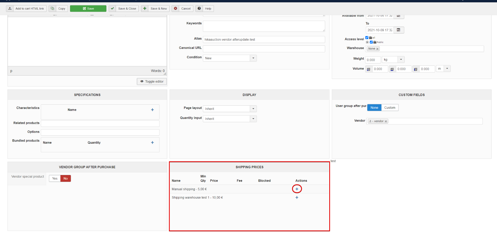

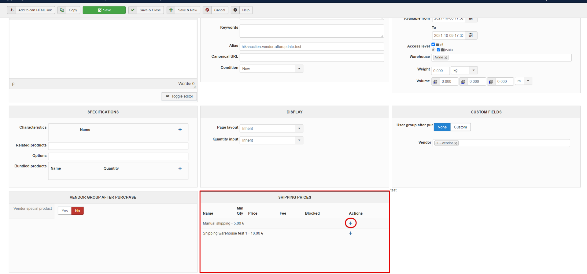

It is already published. Can you take a screen shot to show me what screen you are seeing that option on for the product page?
4 years 11 months ago #336338
Of course.
Kind regards,
Mohamed.
Last edit: 4 years 11 months ago by Mohamed Thelji.

4 years 10 months ago #336515
Mohamed...I apologize, I'm just not getting notifications from this form about 75% of the time.
Ok...I understand what the problem was. The plugin is active, and published, I just needed to add it.
So how can I add this option for these items...and ONLY these items? If I put this into place, it becomes active for ALL items on my site.

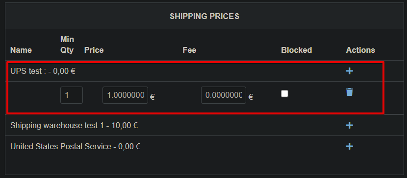

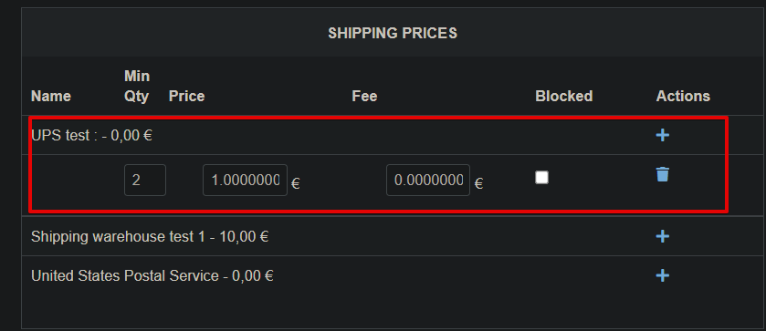

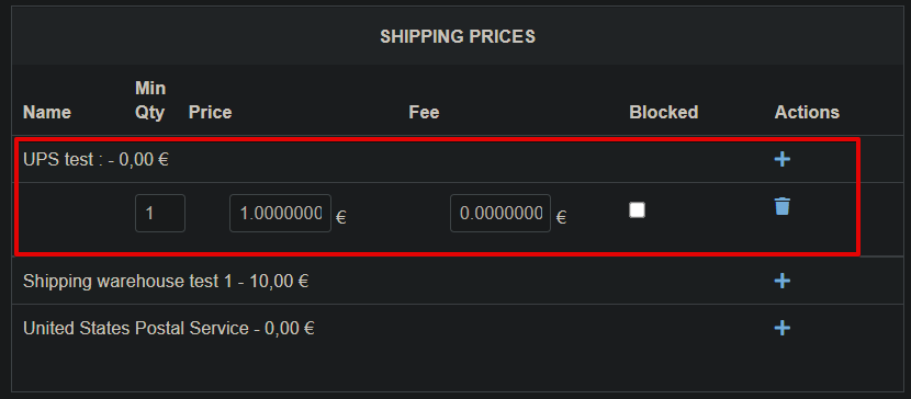

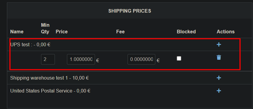

I want to be able to have shipping applied properly via UPS for the correct price of a single item...but, when multiples of this item, or other foam items are added to the cart, I only want the system to charge $1.00 extra per item.
In that the solution will be to configure the "Shipping prices" tab section of your normal products (screenshots 1) and foam products (screenshot 2) like attached screenshots.
Screenshot 1 : It will apply $1 per "normal" product in your cart if there's at least 2 of the same normal product in your cart
Screenshot 2 : It will apply $1 per "foam" product in your cart
Kind regards,
Mohamed.
