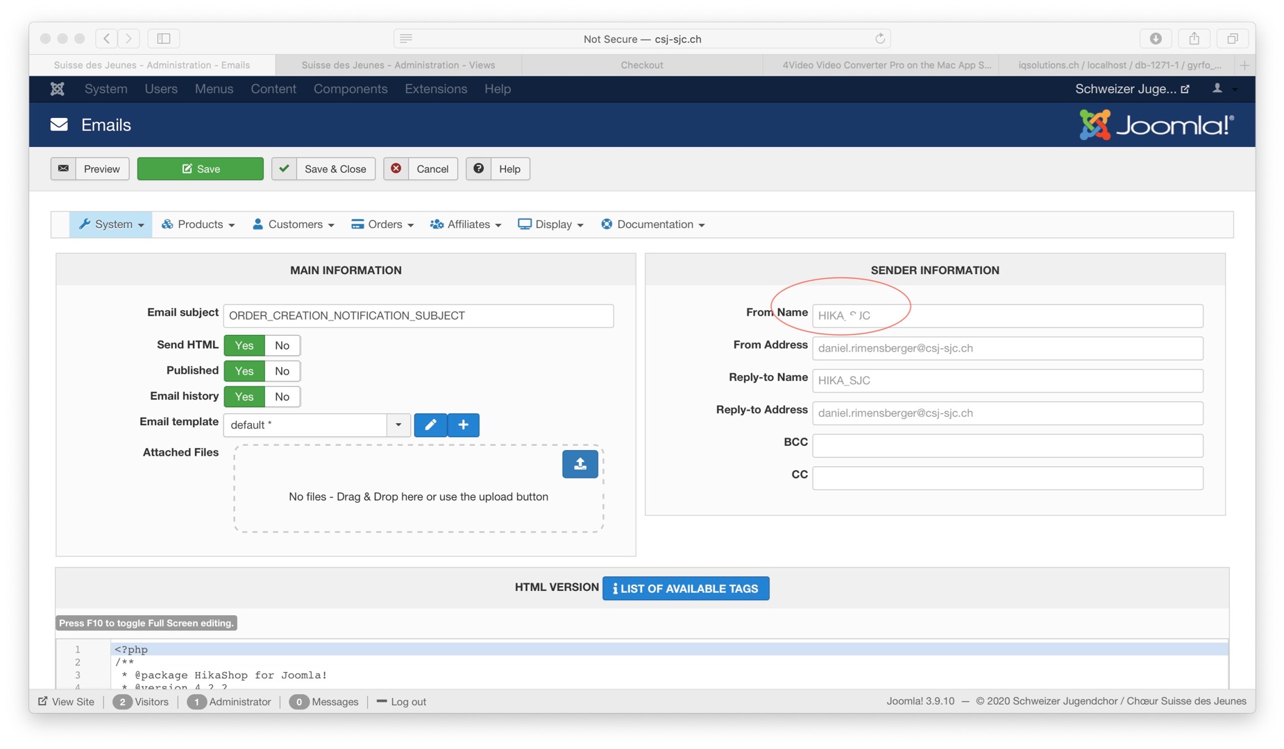

Hi, I would like to be able to replace the sender name by a language string, as I am running a multiple-language shop -> see attachment. Is there a way to achieve this? Thanks for your help! Nicolas

In the HTML or the preload of the email, you should be able to do that with such code:
And then you can add a translation override like that:
FROM_NAME_IN_EMAILS="Sent by me"
Code:
<?php $mail->from_name = JText::_('FROM_NAME_IN_EMAILS'); ?>

Worked wonderfully, thank you very much! N
