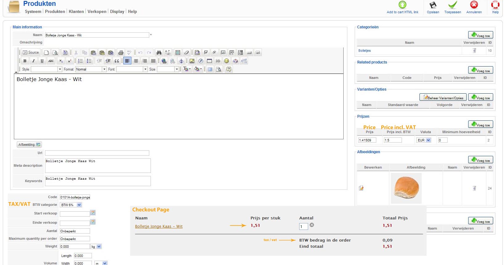

After hours of strugling with the TAX setup I finally succeeded (I think). I have setup two TAX rates rules (VAT is called BTW in the Netherlands): 6% for food and 19% for non-food or alcoholic drinks. Customers who buy are all in the Netherlands. Edited an existing food product and applied the tax rule 6%. There is everything ok.

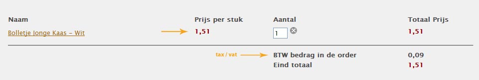

Also on the product page where it says EUR 1,50 incl.TAX. But on the Checkout page the price is EUR 1,51? Seems to be a rounding issue. Any solution? Since TAX/VAT here has to be paid over the total amount of each order.

Which version of HikaShop do you use ? Did you try to update ?
Also, there is this post which might help you if you still have the problem after that: www.hikashop.com/en/support/forum/4-how-...blem-on-product.html

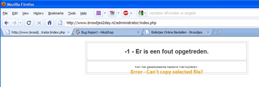

Thank you. I have version 1.4.5
Tried to install 1.4.7 but then get an error -1- Can't copy selected file.
Manual Upload?
Manual Upload?

"please look in the file adminsitrator/components/com_hikashop/classes/currency.php in the function addTax near the end of the file. Could you try to remove the line:
$price->price_value = round($price->price_value,$round);
and see if the price is correct after that?"
