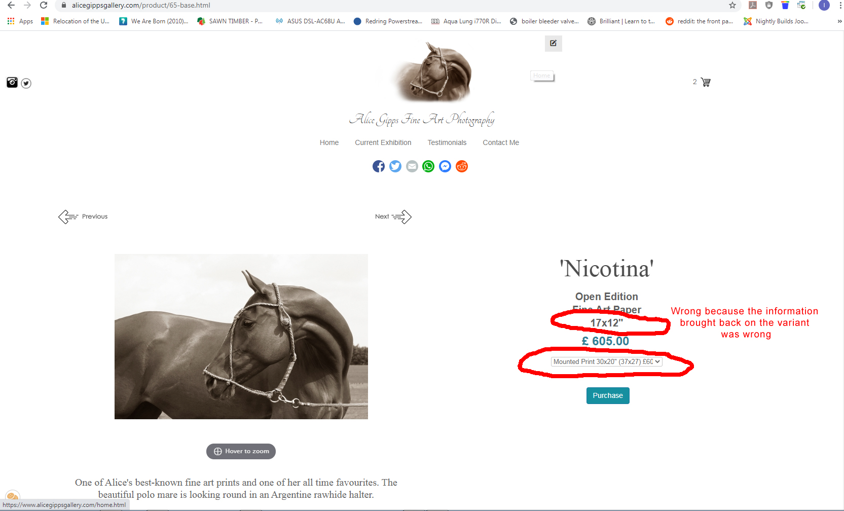

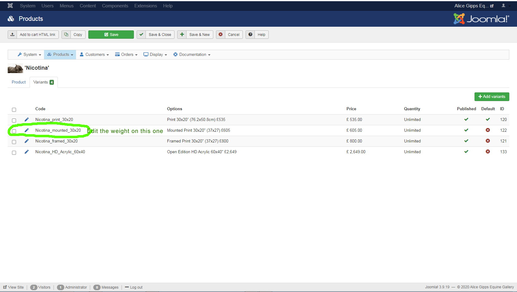

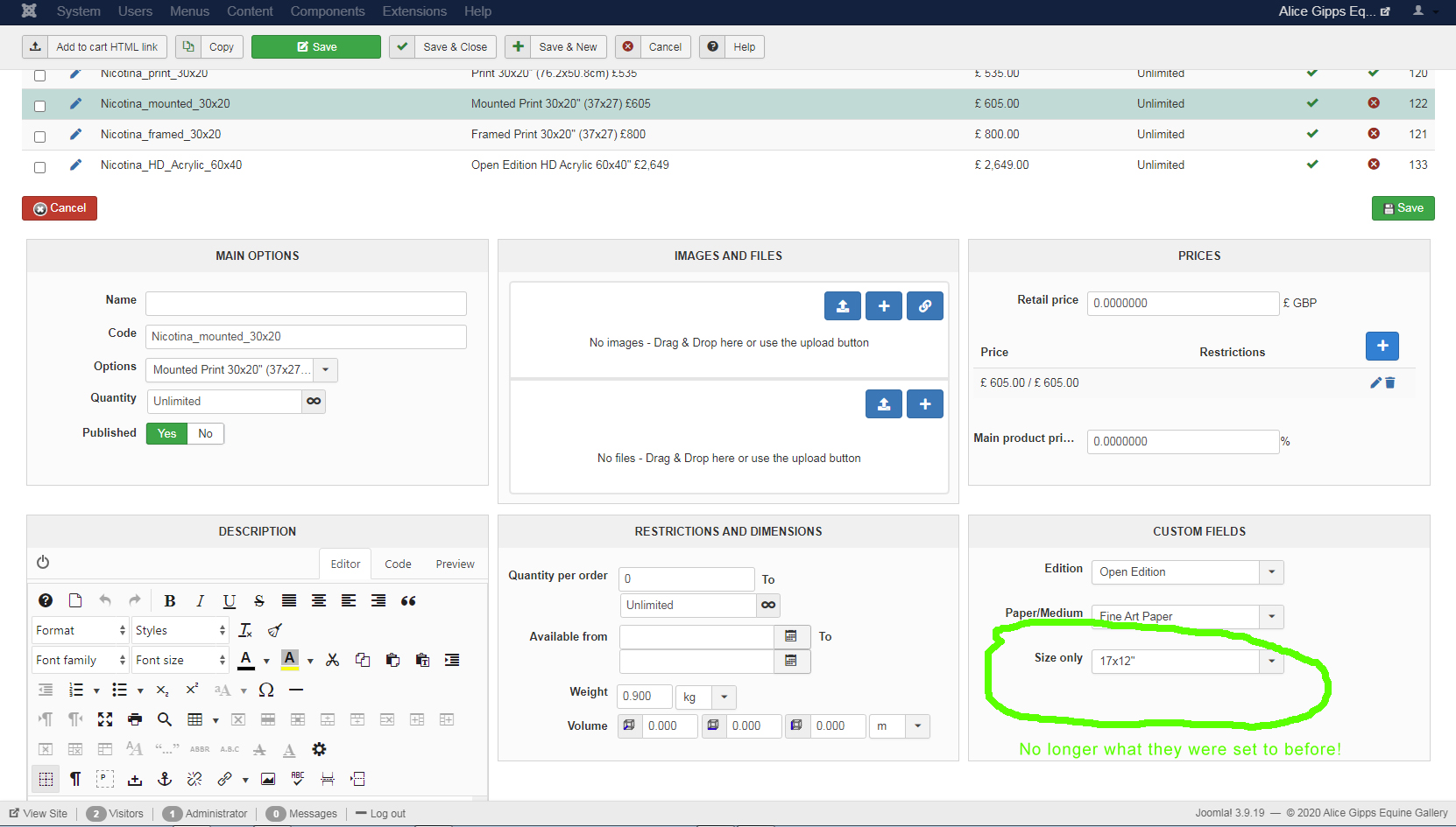

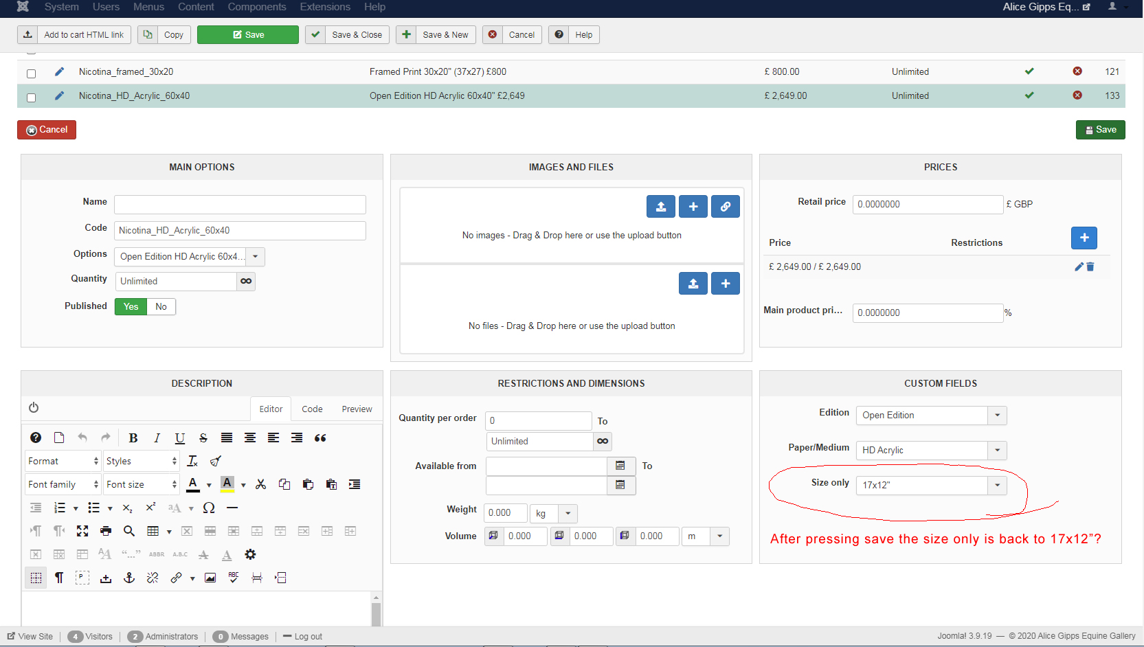

It's still doing it. If I add weights to the variant and save, it's overwriting the previous values for the custom fields as this is what i has brought in on loading the variant. Here are the screen shots.
Effectively this means I have to set the custom fields again each time I make an amendment to the variant.
Ian

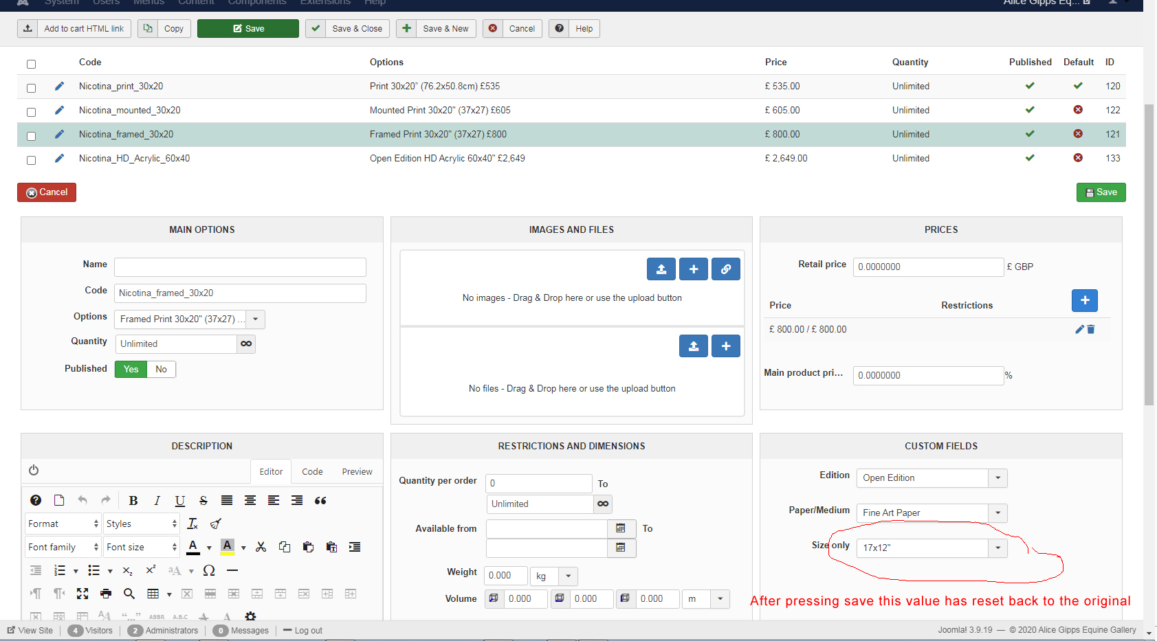

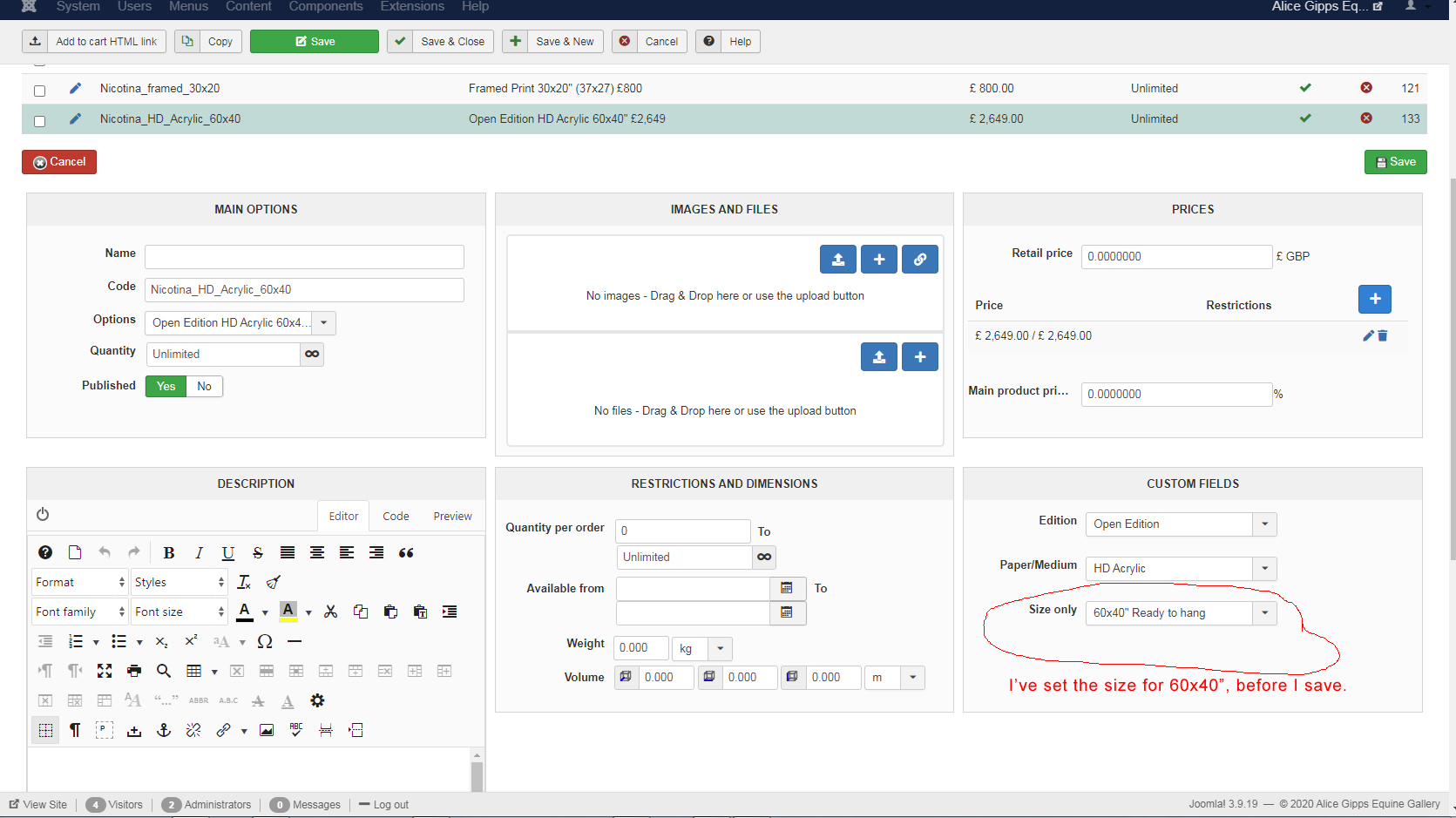

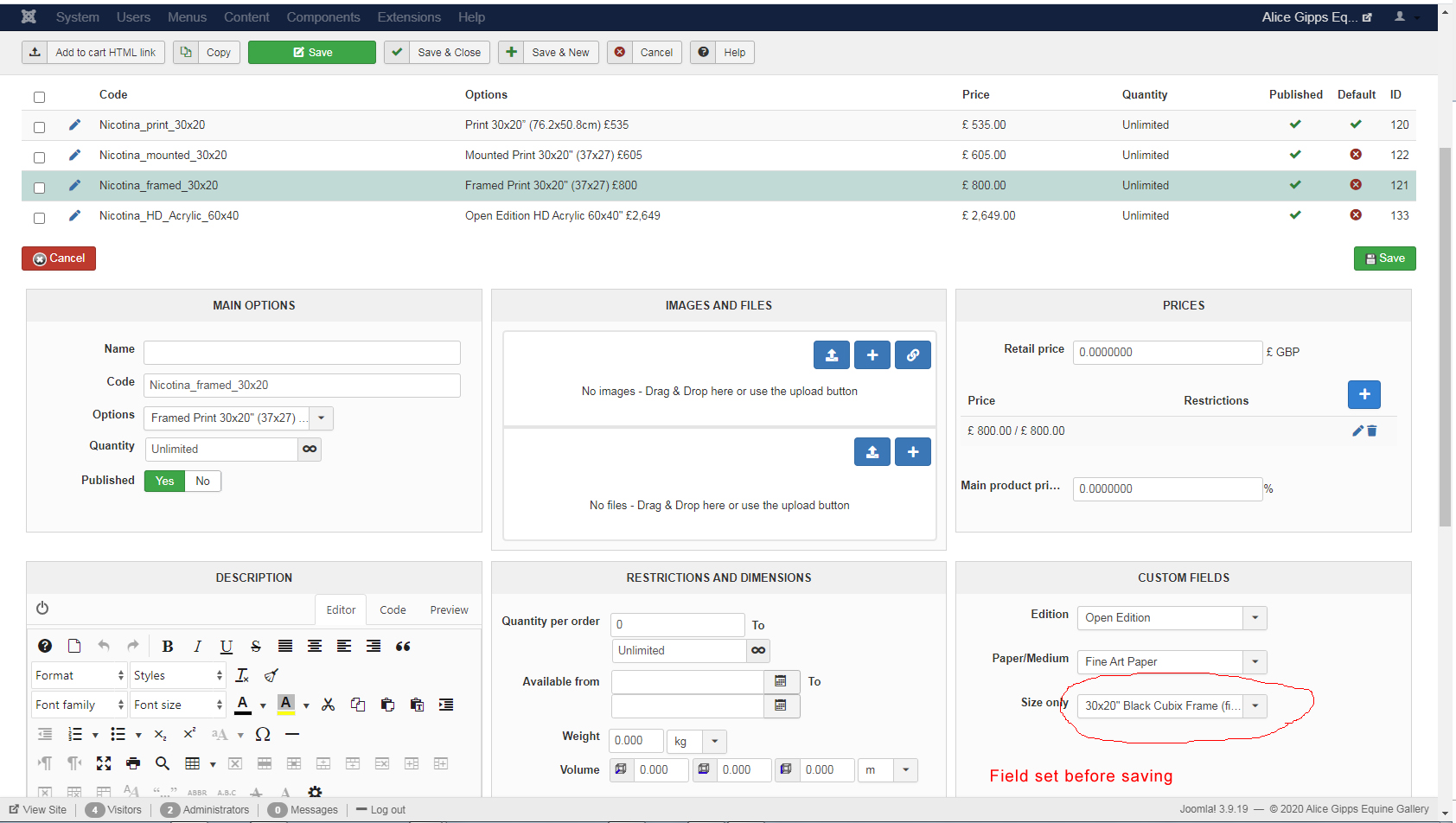

The problem is the last custom field "Size only", it gets updated with the generic data from the product, ie. the default value (12x17"). The custom field keeps reverting back to 12x17" every time.

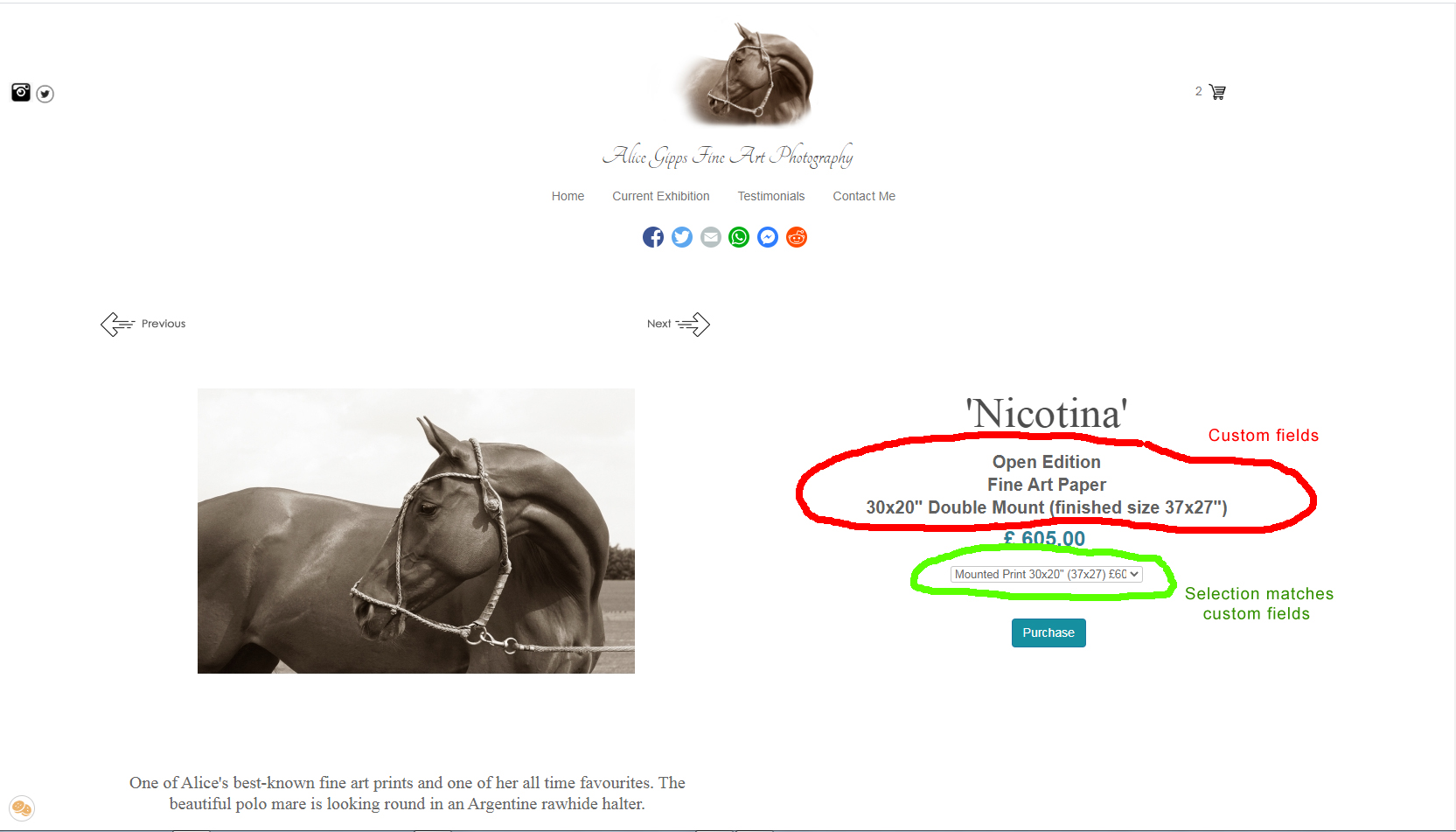

I can see when you have been testing because you have changed the custom fields and they show on the front end.
I have sent you a video as I could not upload it here. It shows the error happening.
It appears that the field is using the default value form the custom field for some reason.
So whatever I set the "size only" custom field to in the variant, it always reverts back to the default value (12x17") of the custom field when you save.
Ian
