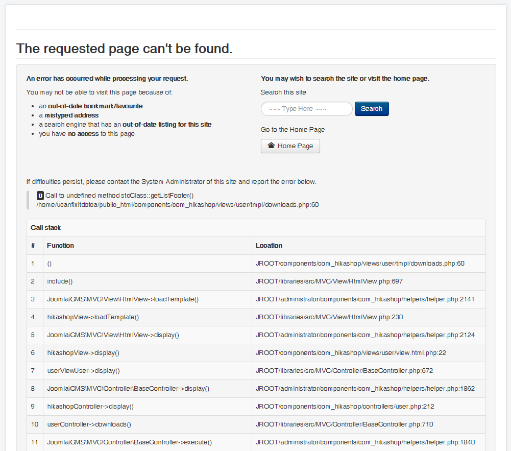

-- Error-message(debug-mod must be tuned on) -- : 0 Call to undefined method stdClass::getListFooter()
hi Everyone I have been putting this off for a long time but I need it resolved. If I put and item in my cart, checkout and then pay for it the product download page does not work anymore I get an error like you see in the attachment.

6 years 8 months ago #314387 by nicolas
Please activate the "debug mode" and "error reporting" settings of your Joomla configuration and access that page again.
It should display an error message with more information on the issue which will allow us to tell you what to do.

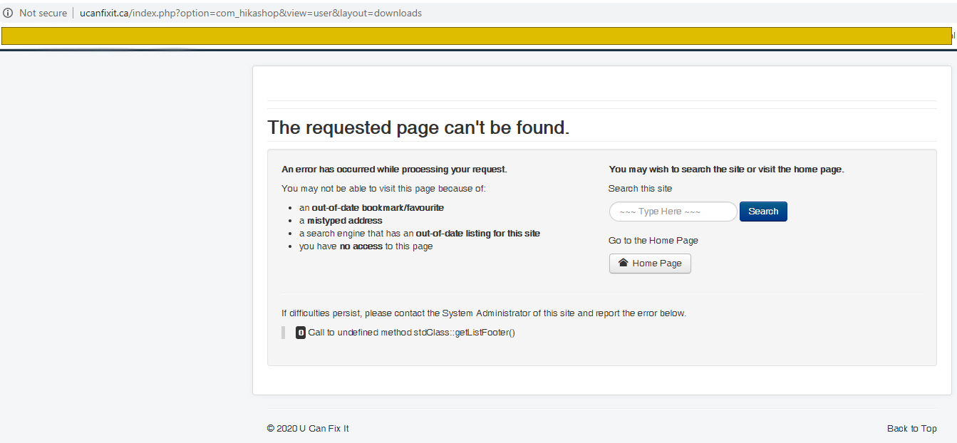

6 years 8 months ago #314442 by ucanfixitca
Please see attached images:

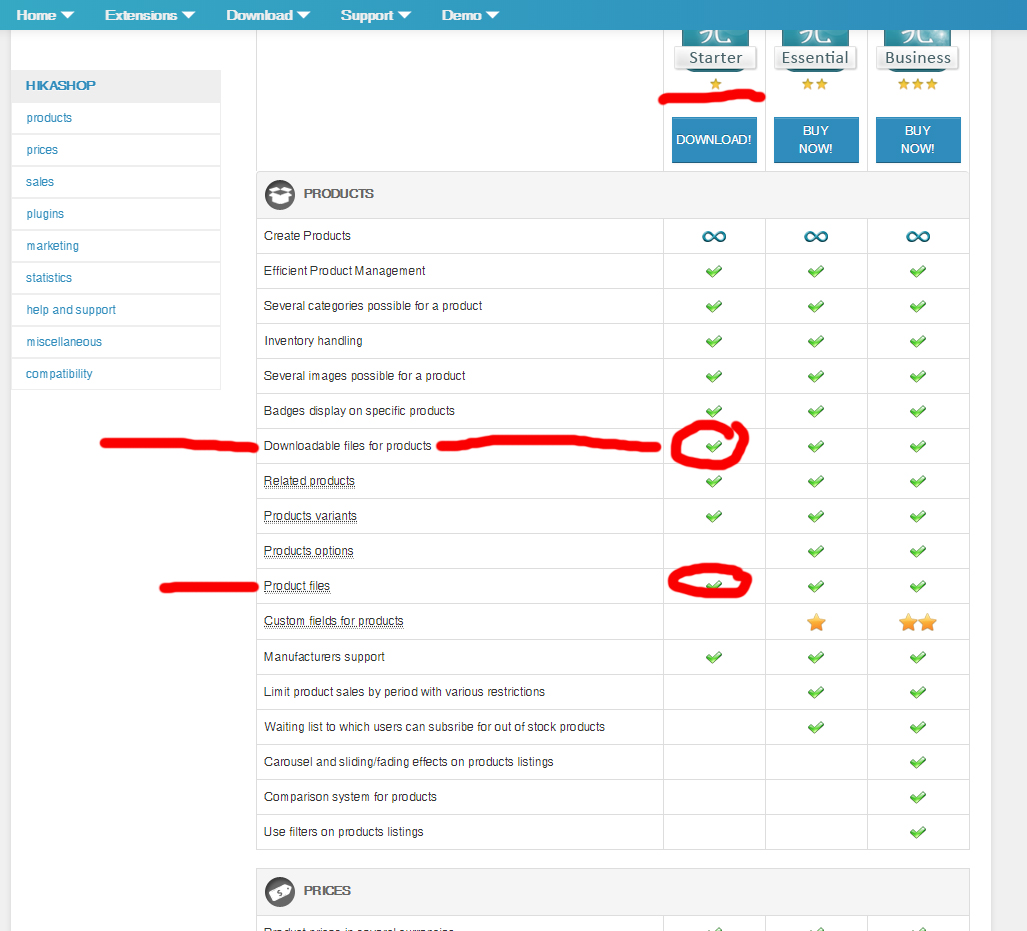

6 years 8 months ago #314668 by ucanfixitca
Mohamed, Im not sure I understand your response. Do I need to BUY essential version or not? It clearly shows on your website that the starter version that I am using supports downloads. See attachment below:
Please advise, I am loosing business because of this problem and orders are piling up with angry customers.

6 years 8 months ago #314669 by Jerome
By using HikaShop starter, you do have the "product files" and your customers CAN downloads the files via the orders.
If they open the order details in the front-end or open the notification emails they received, the download links will be available.
Now, when you're talking about the "download listing" page ; it is another feature which is only provide by commercial edition of HikaShop.
You will find another thread, from about two years ago, which is talking about the same exact issue for a "getListFooter" bug on the download listing which is not available in HikaShop starter :
www.hikashop.com/forum/install-update/89...stfooter.html#290156
Once again, HikaShop starter do provide download features, but only via the order details and notification emails.
For "free files", they are also available in the product page, for every edition of HikaShop.
