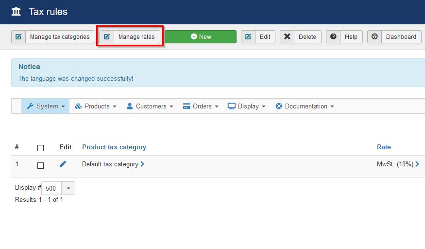

6 years 3 months ago #321432
by nicolas
Replied by nicolas on topic New tax rate in Germany
Yes, you can click on the "manage tax rates" button to get to the listing of rates and edit the rate and change its percentage.
Or you can create a new rate instead, and duplicate your tax rule in the System>Taxes listing and use the start/end date options of each rule so that the tax rate will automatically switch at midnight on the 1st without you doing anything.

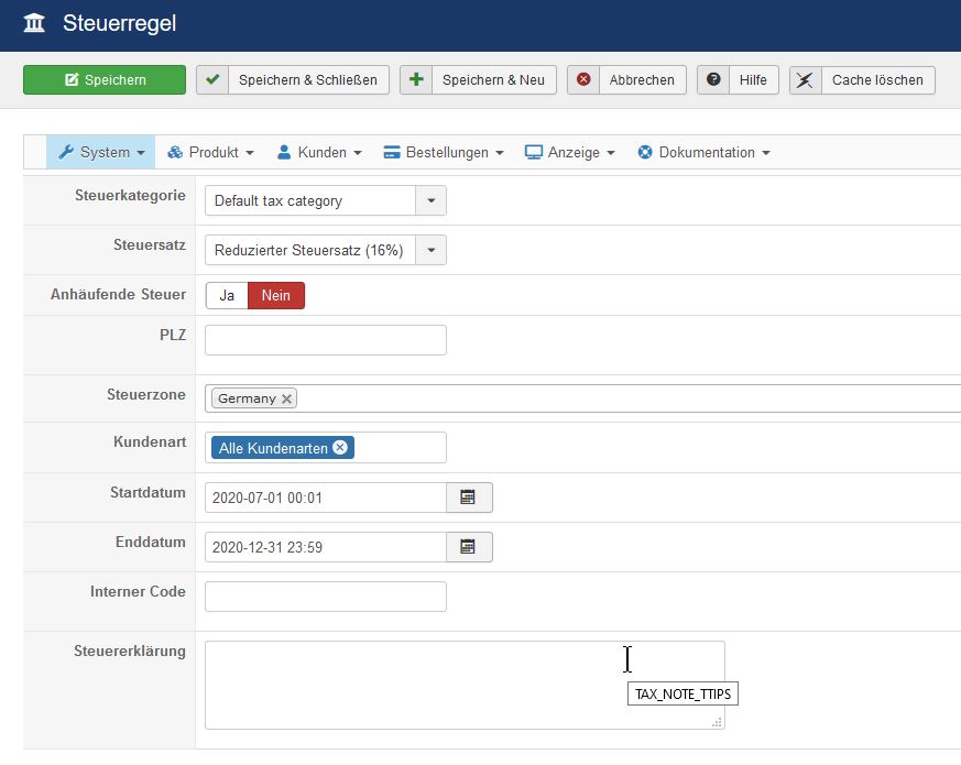

6 years 3 months ago #321455
by CorneliaML
Replied by CorneliaML on topic New tax rate in Germany
many thanks for your fast reply and for pointing me (again) in the right direction
So the config should look like in the attachment?
Best regards
Torsten
Best regards
Torsten
6 years 3 months ago #321462
by nicolas
Almost.
Two things:
- You want an ending date for the second tax rule so that it swaps from one to the other.
- You used the word "German reduced". Note that this text will appear on the checkout, invoice, emails, etc.
So I suspect you want something like "MwSt. reduced" (and probably translate reduced in German)
Two things:

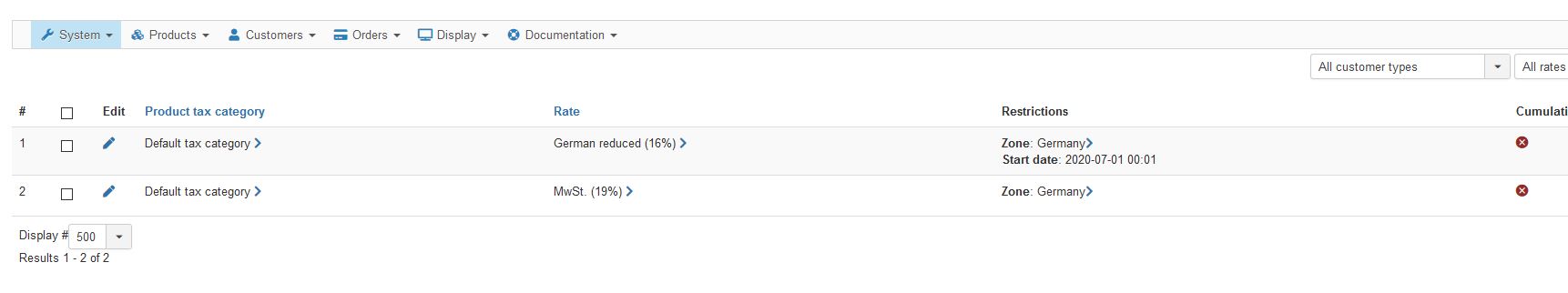

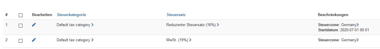

6 years 3 months ago #321488
by CorneliaML
Thanks for the update, Nicolas. I´ve created a new rate now, see attachment.
There was already an end date set but it is only showing the start date. Will the "MwSt. (19%)"-tax rule automatically disabled when the new rule kicks in tonight?
Many thanks
Torsten

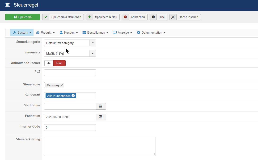

6 years 3 months ago #321490
by nicolas
No, I mean you need to add an end date to the 30th of june at 23:59 in the other tax rule so that it disables it when the other kicks in.

6 years 3 months ago #321492
by CorneliaML
That was also set, not sure why it´s not displaying:unsure:
6 years 3 months ago #321498
by nicolas
Then it's all good. There is a bug on the listing leading to the restriction on the "end date" not display. We'll fix that for the next release.
I just wanted to make sure with you that is was all set properly as I couldn't see the "end date" restrictions on your screenshots.
