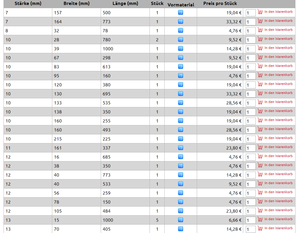

I know that I can show product weight, length, width and height in product view, by switching it on in Options. How can I show them in category view?
I am especially interested to create 3 columns: length, width and height in Table view for a category, to have 3 additional columns.

7 years 1 month ago #310499
by bolando
Replied by bolando on topic How can I show weight, length, width and height in category view?
Yes, I attach what I would like to achieve on category page.

You'll have to edit the file "listing_table" of the view "product" via the menu Display>Views.
There, you'll have to add the tr/td cells for the title of the columns and for each product.
The data of the products is available with such code:
<?php echo $this->row->product_height; ?>
