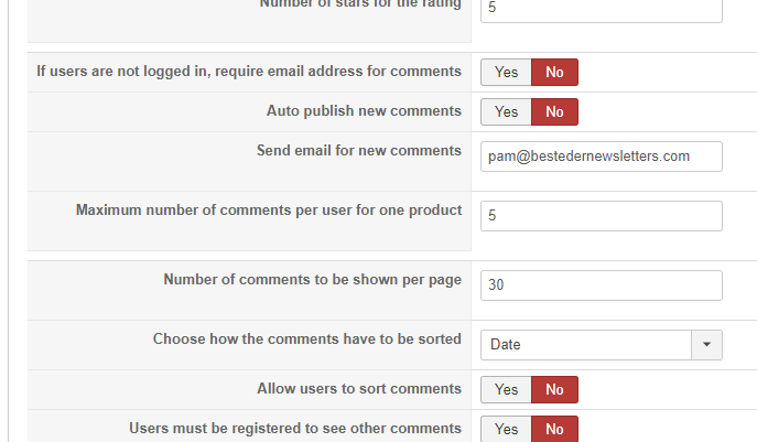

I set it so that comments and vote don't automatically display because I want to review them.
However, I'm not getting emails that somebody left a comment.
I tested it out myself and no admin email.
Can you help me figure out why that is?
Pam

8 years 5 months ago #290991
Did you enter your email address in the setting "Send email for new comments" of the HikaShop configuration ?
Otherwise, the email won't be sent.
And if you did, did you check that the "new comment" email it published like Mohamed asked ?
Finally, HikaShop stores each email it sends and you can look at them in the menu Customers>Emails history.
So please check there if you see the new comment emails or not.
If you do but you don't receive them, there is a problem with your email server or the emails are seen as spam and rejected.

8 years 5 months ago #291004
nicolas wrote: Hi,
Did you enter your email address in the setting "Send email for new comments" of the HikaShop configuration ? Yes
And if you did, did you check that the "new comment" email it published like Mohamed asked ? I'm not sure I understand this. Where would this be to turn on or off? I don't want it automatically published, though.
Finally, HikaShop stores each email it sends and you can look at them in the menu Customers>Emails history. Yes, thank you, yet I don't want to have to keep going to the backend to see IF anybody commented..which is why getting the email is important.
I do get other emails from the store for orders received, etc....so not sure why this particular email would be spam?
Thanks so much for your comments,.
