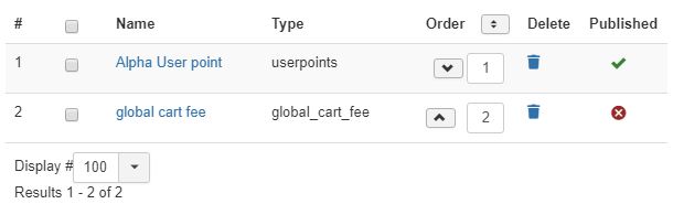

Description
This screen enables you to manage all your shipping or payment plugins. The interface is the same so the documentation is the same on this screen, but the shipping plugins and payment plugins are accessible by two different HikaShop menus
Toolbar
- Copy : Select one or several Plugins and click on this button to copy them all.
- Publish : Select one or several Plugins and click on this button to publish them all.
- Unpublish : Select one or several Plugins and click on this button to unpublish them all.
- New : This button enables you to turn ON/OFF the help section, this screen will appear or disappear.
- Help : This button enables you to turn ON/OFF the help section, this screen will appear or disappear.
- Dashboard : You can go back to the control panel using this button.
Column Headers
# : An indexing number automatically assigned for ease of reference.
Checkbox : Check this box to select one or more plugins. To select all items, check the box in the column heading. After one or more boxes are checked, click on the delete button in order to delete the selected categories.
- Name : Name of the plugin. You can click on it to edit it.
- Type : You will find a definition type, example : - Payment plugins : HikaShop Paypal payment plugin - Shipping plugins : HikaShop Fedex shipping plugin - Other plugins : The type will most often explain in own purpose
- Order : It enables you to order your plugins of the current level the way you want.
- Delete : Click on the little trash icon to remove the instance.
- Published : If a plugin is published it means that it can be used by your customers during the checkout.
