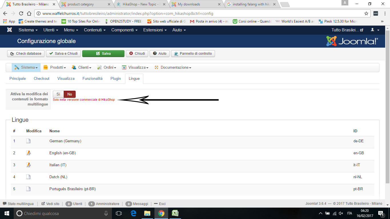

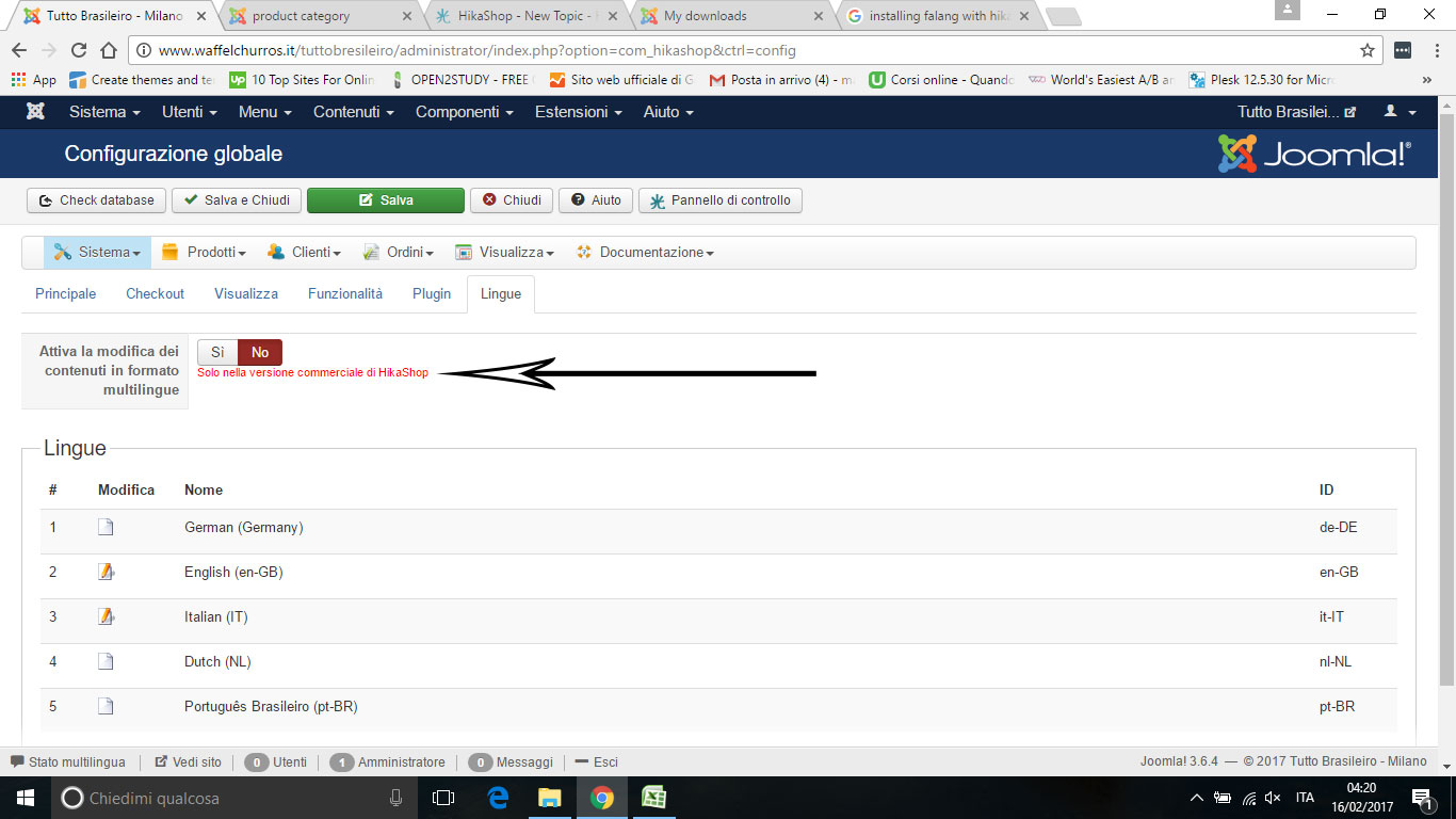

-- Error-message(debug-mod must be tuned on) -- : "Only available with hikashop market"
My client needs to manage products translated in 3 langages. It seems the best solution is using Falang plugin.
Do you have some guidelines to integrate Falang with hilashop?
In hikashop\configuration\language I see option to activate "modify contents in multilanguage format" that can be used only with hikashop comm ercial version.
What does it means? I will not be able to translate products and categories?
Thanks for your help

That option allows you to activate the translation edition interface in HikaShop so that you can easily translate the content of HikaShop in the interface of HikaShop. For example, when you edit a product, you'll get flags you can click on to get the translation fields and simply fill them.
You can still use Falang and HikaShop Starter together without that.
That just means that you'll have to translate your HikaShop content via the Falang interface.
